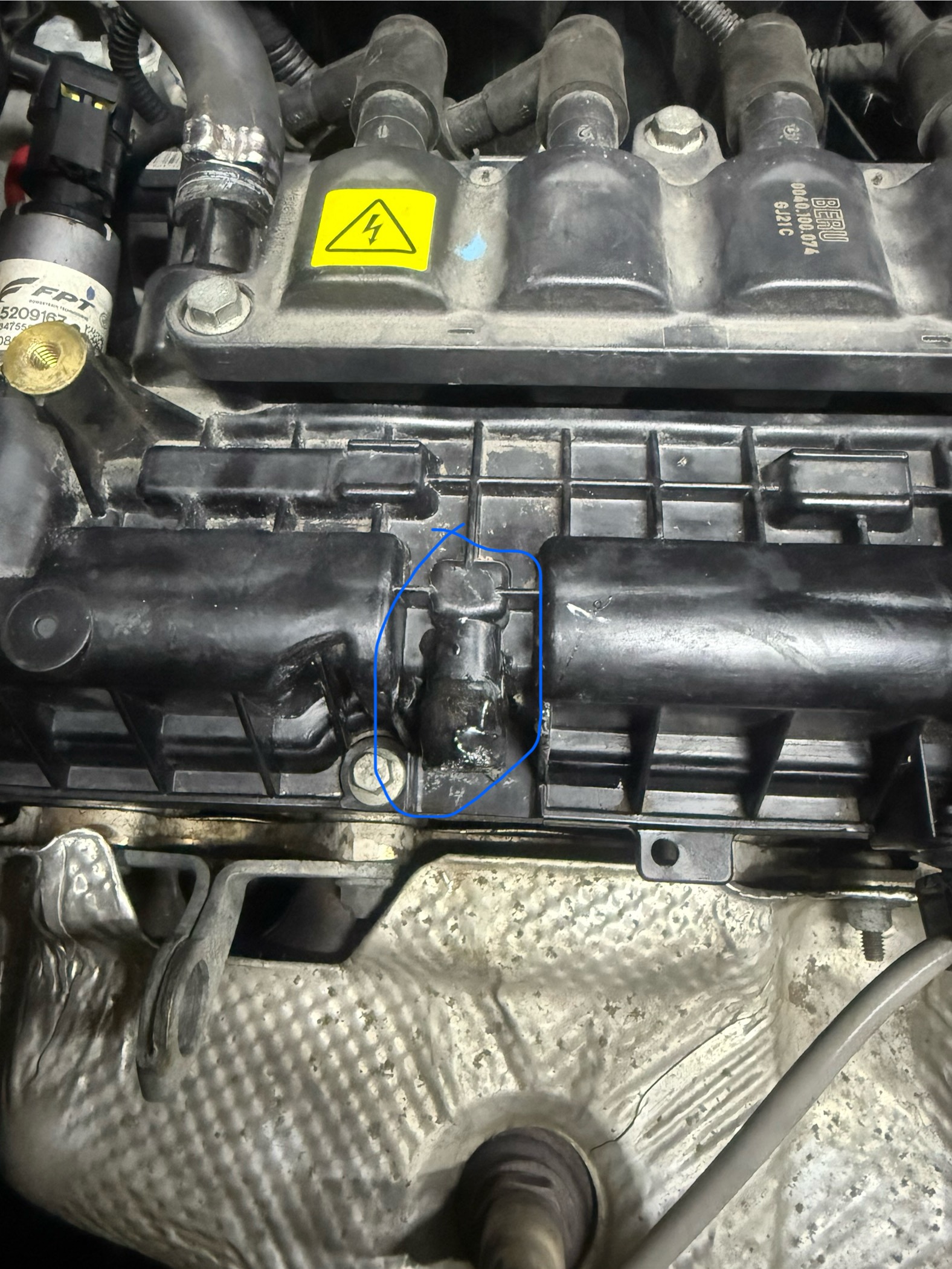

I had a leaking Cam cover usual issue , plastic cover, plastic bug seems to give up and leak. I initially removed the bung and put a bit of gasket maker in and then epoxied it. this didn't work and carried on leaking. everything else was working as normal at this point.
I then decided to remove the cam cover and seal it properly, so removed it, cleaned it, gasket maker, plastic weld and then epoxy. put everything back together and leak fixed.... however... this is where the errors started.

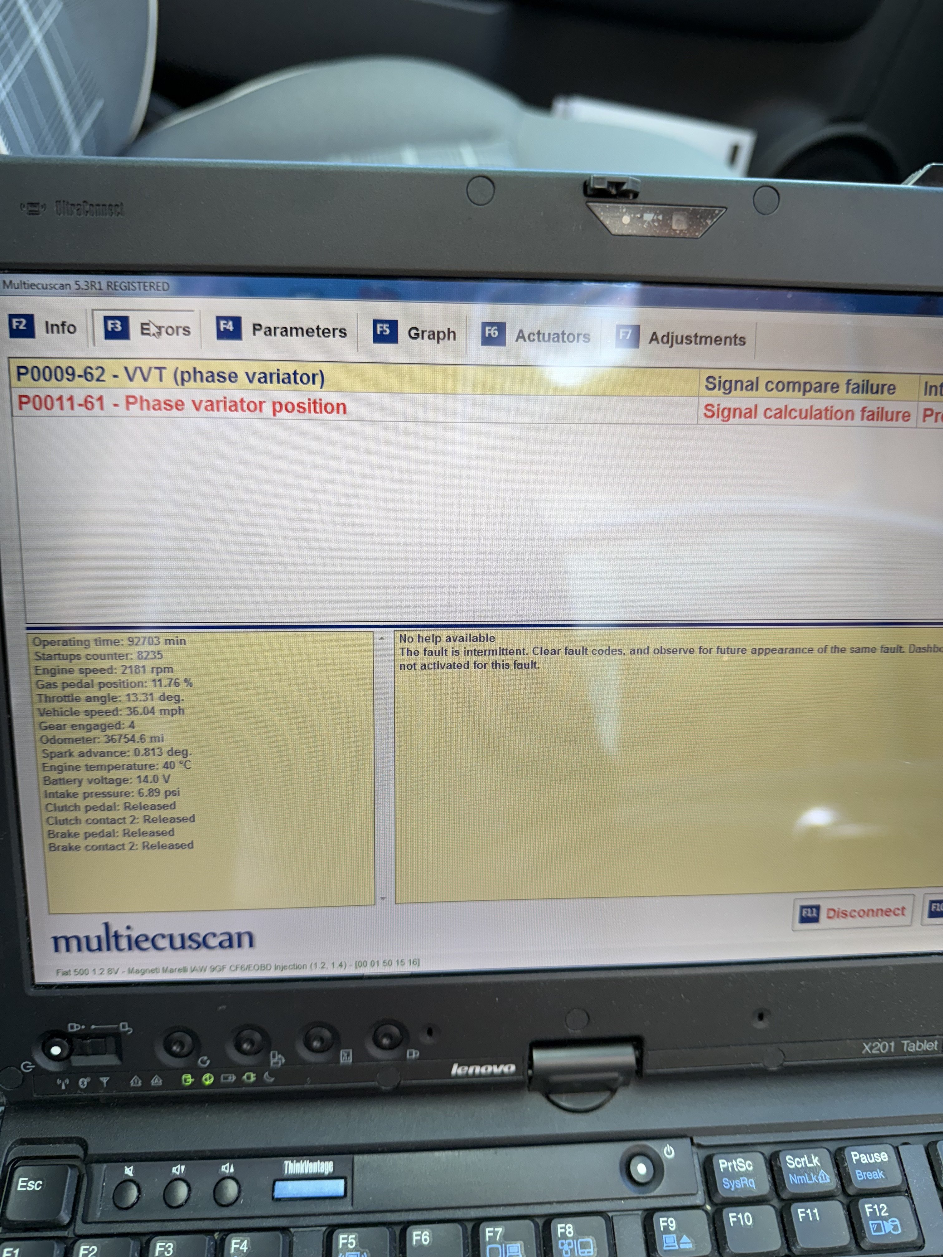

Initially I started getting P0008 P0009 errors, I replaced the Cam sensor, error still there, I then read about the cam cover alignment tool, so I bought this aligned it and all seemed well, after a short drive P0009 + P0011 errors.

the exact error is
Whilst driving just below 2k rpm seems a little jerky , then on load up hill etc power drops and then engine light.
