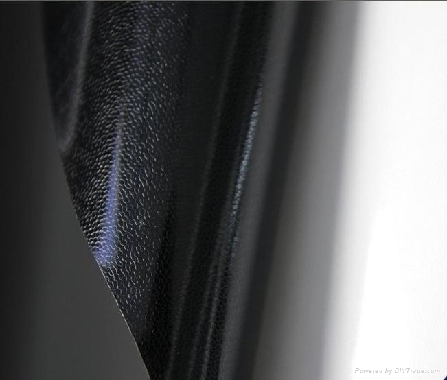

Just buy (on eBay) air/bubble free vinyl, it has tiny lines on the adhesive side, which allow the air to get out. I met a guy who installed bubble free gloss vinyl on his punto, he said it was as easy as taking candy from a baby and it was 100% perfect. Just a slide with squeegee, and the job is done! But it is a bit more expensive.

Get bubble free vinyl, much easier to fit!
