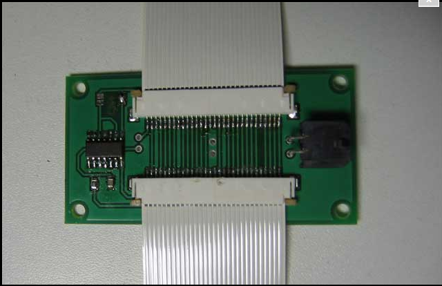

Hi Guys!
I Have done, i built a video interface to watching videos, films, playstation, TDT, etc.. in our fiat stilos with Connect Nav +
Now, we can enjoy of a video input!!
You can ask any question, i try to answer!!
Regards!!

Is possible, i could build some video kit but before i need to know more or less how many people want to buy the video interface, so i can know how many material is necessary for all members of forum. With a little time, i can build several interfaces.

In principle, you need aux in, FM modulator, cd changer or cdc emulator (loudlink or bortesi interfaz) to listen the sound.
With my interface you can get video signal but is important that you have one of previous devices to listen the sound correctly. I am thinking how to build a cheap sound interface to have all without any sound device.
Too, is important that the format always be NTSC, because connect nav+ only accept this format. Your DVD must accept this tv system but normally all DVD have this option. In any way, you can buy a PAL--> NTSC converter.
