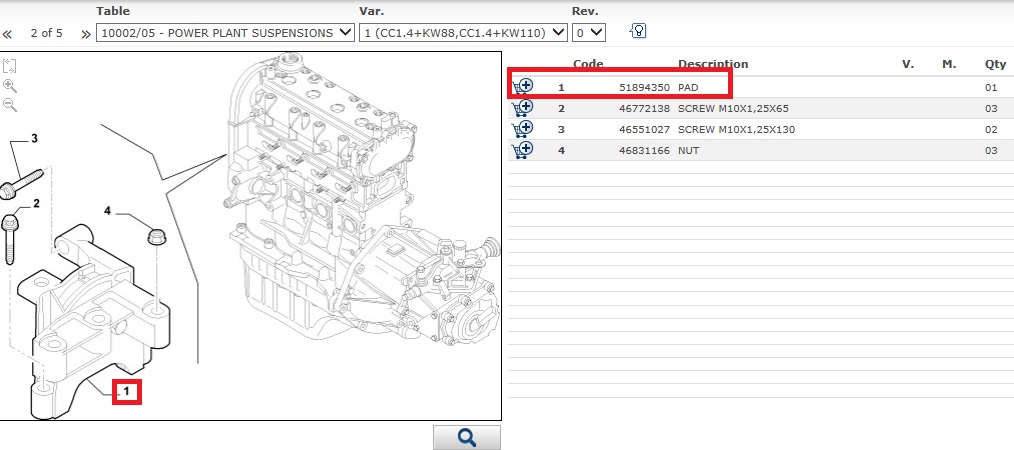

Which one mounting cause vibrates on page 4?

Usually is the main engine mount.
But in Singapore, most of us change 3 altogether.

This one on photo?
And could this cause other damage?
