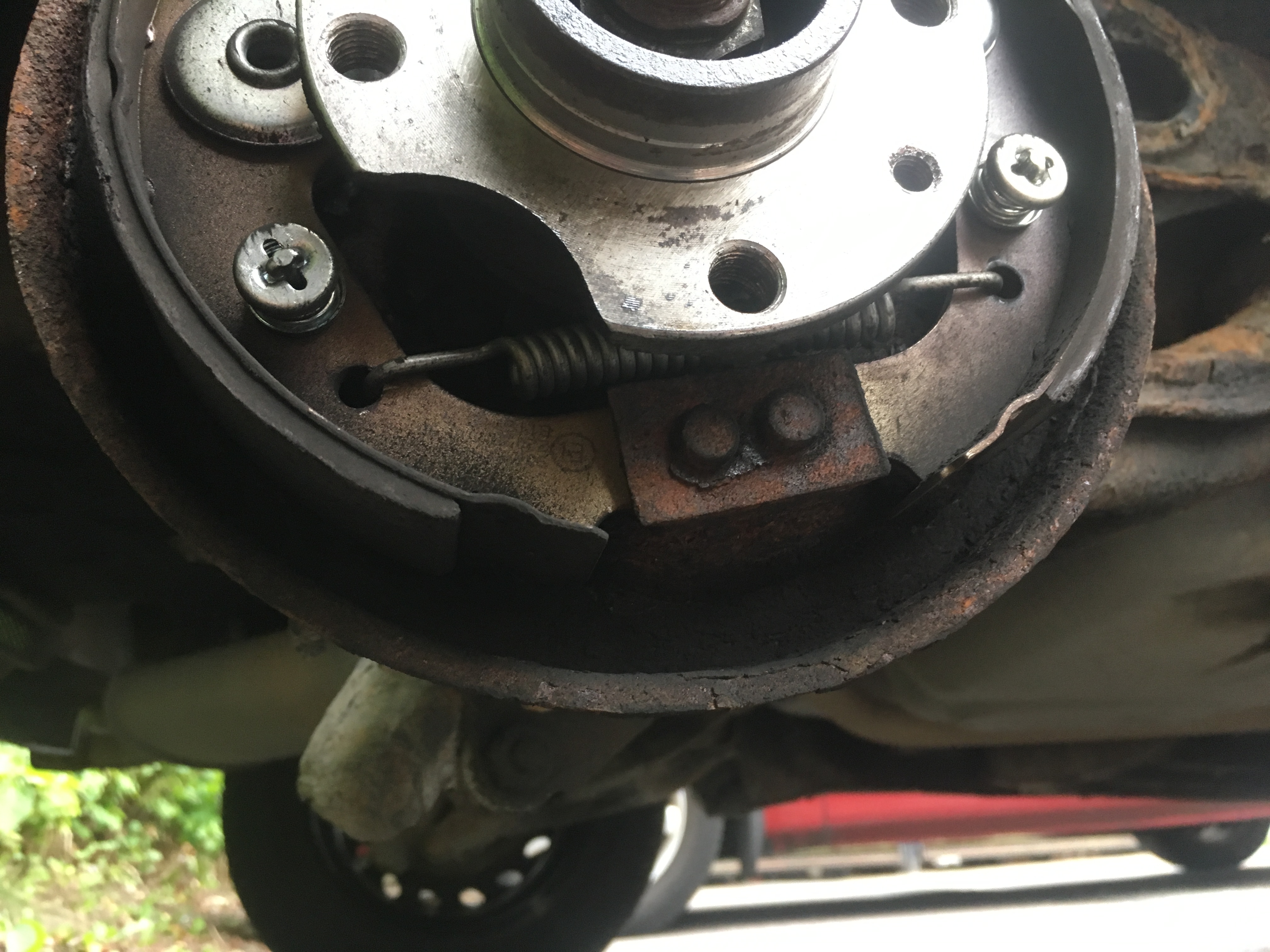

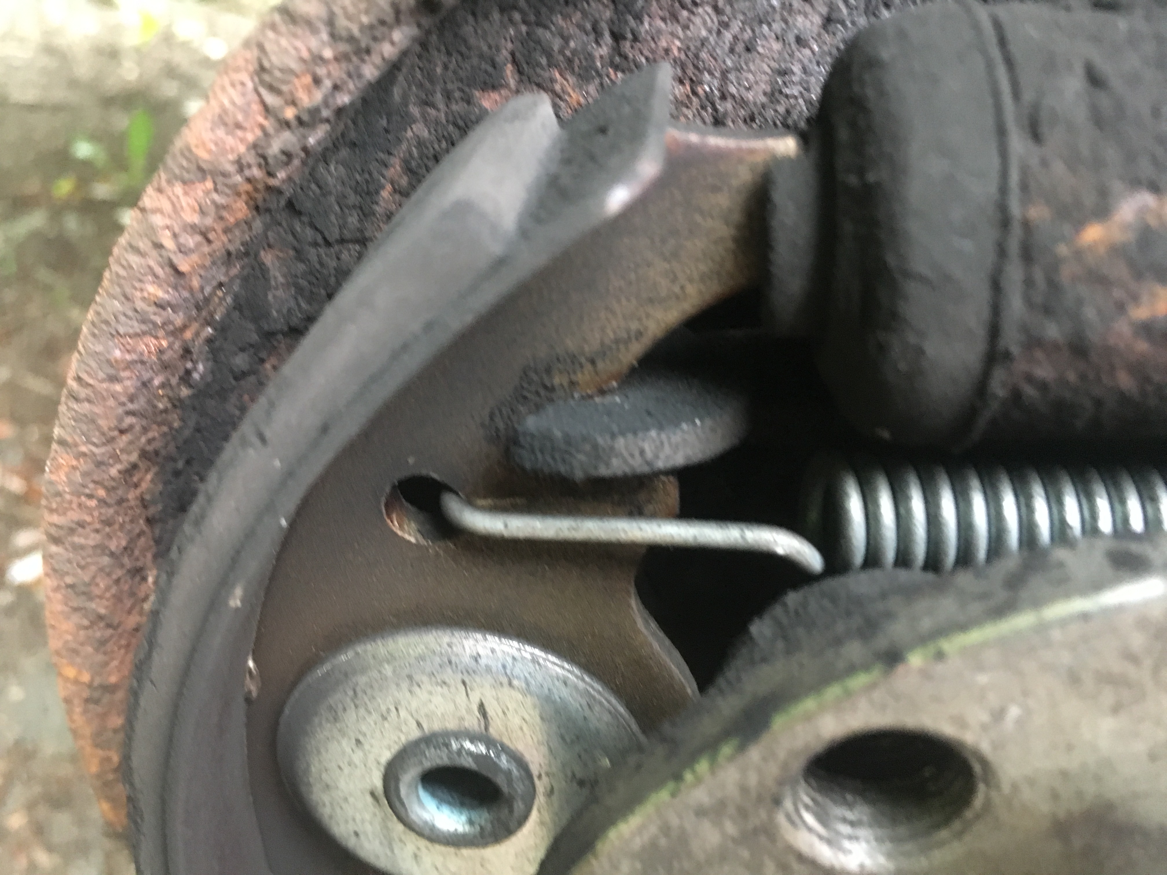

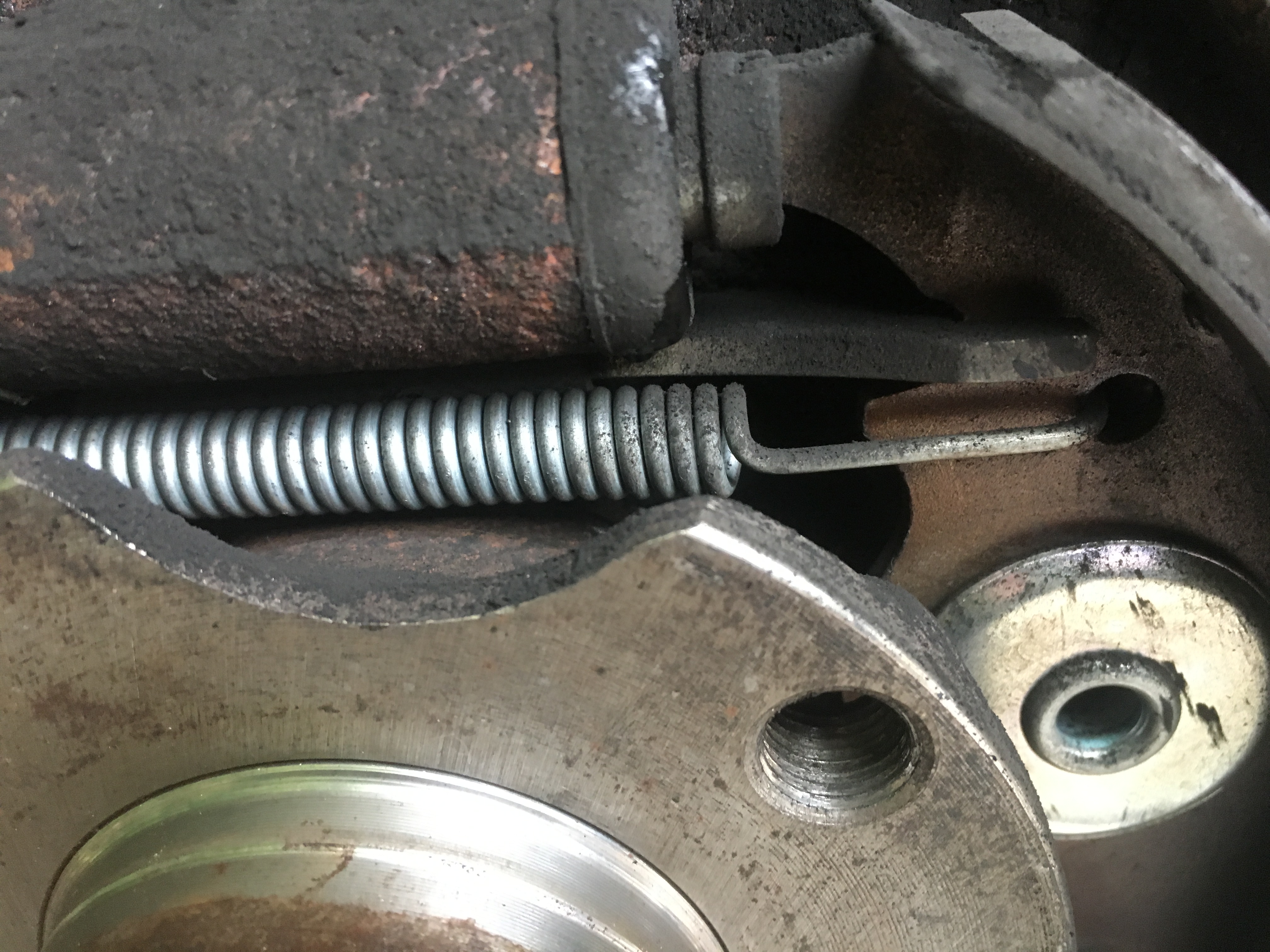

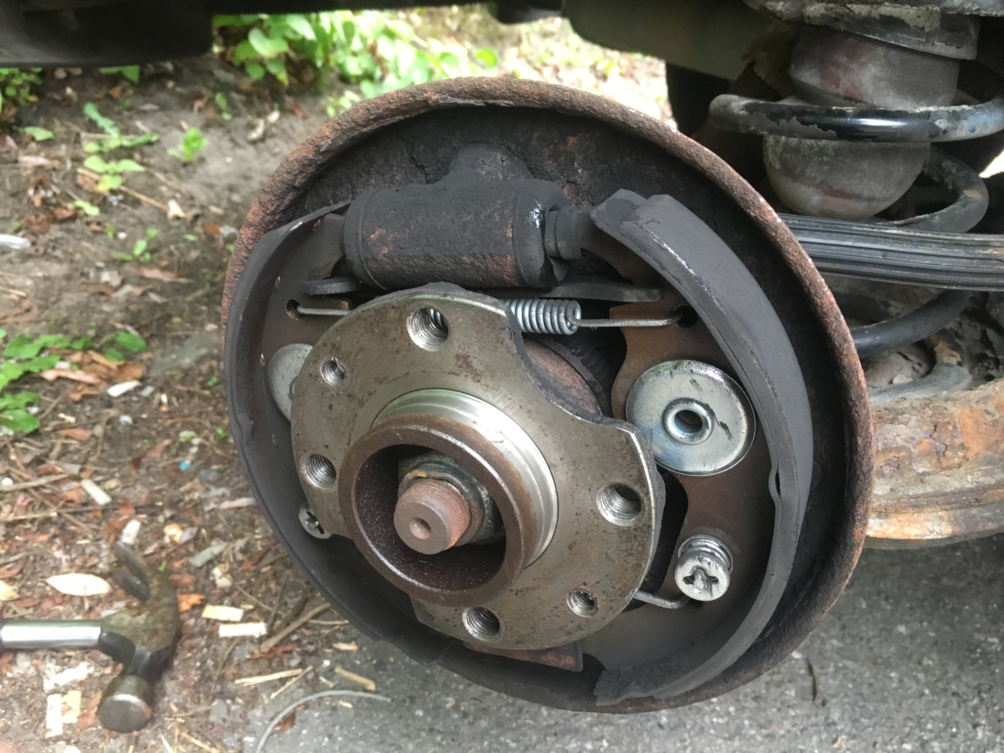

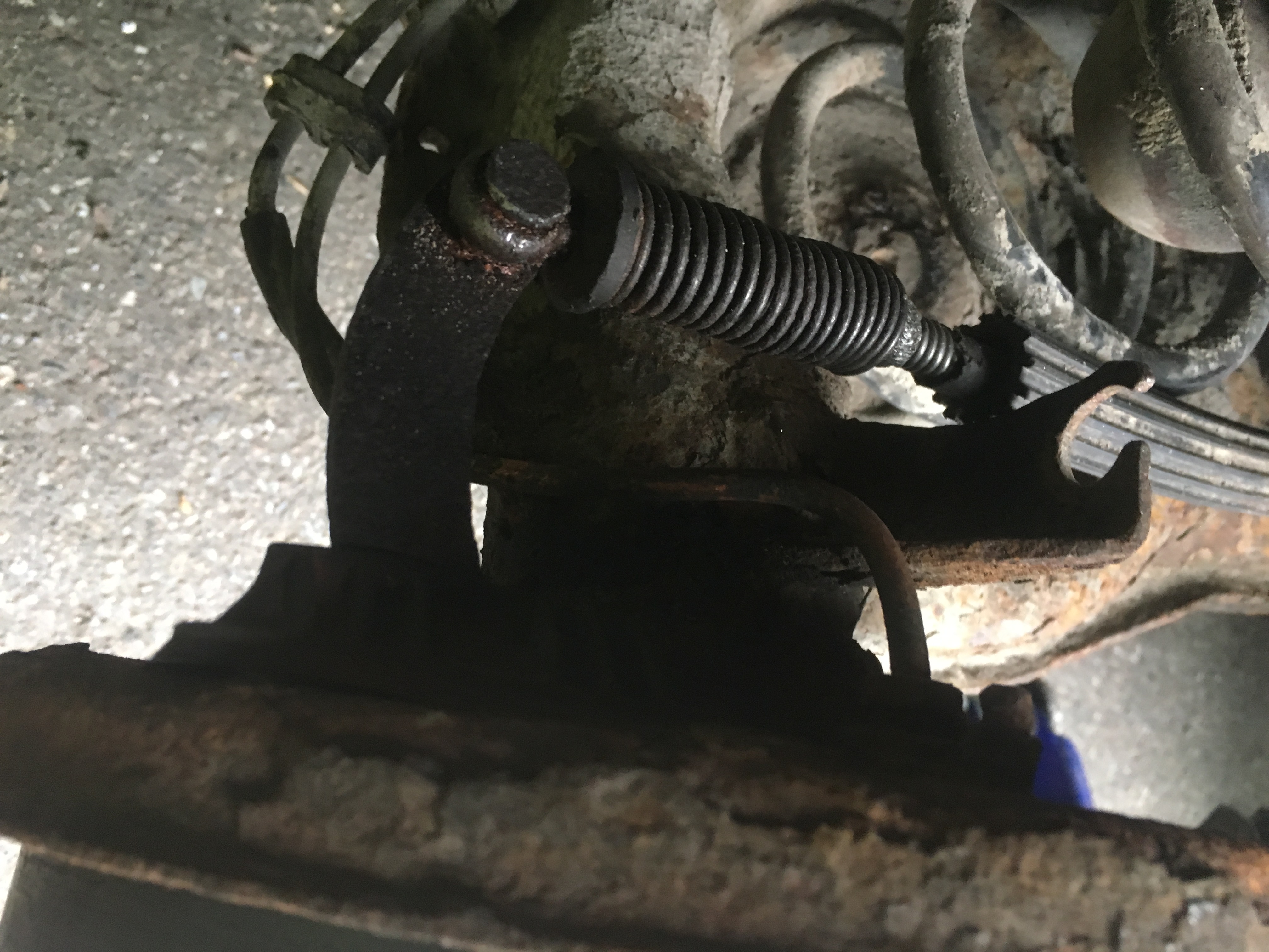

Okay back with some pictures here.

It has the same symptoms as before I touched the brakes. So maybe the problem isn’t from my work. I do have new wheel cylinders and the cable, so could try doing those too. Just need to find a way to remove the split pin from the arm, as it is rusted together.

The assembly looks fine. Also the handbrake lever. So as soon as the handbrake cable is back in its slot the drums will not fit any ore ? If so i would think about replacing the cable completely.
The wheel cylinder pistons look a long way out. Are they seized?
Might just be that the shoes need pushing inwards, to slide them on the adjusters. This will push the cylinder pistons back in and allow the drums to fit without dragging.
Do need to ensure the handbrake cables have some free play when released.
The cylinders can be pushed inwards with fingerpower, so I would not think so. I do however have two lying around. My brake lines just looks a bit dodgy, and I think the cylinders look to be in good knick anyways.
I have forced the shoes inwards all they will go. The elbow link prevents them from going further inwards.
But yes, as soon as the cable is mounted in the bracket, which in the right side is not even possible, it pushes the shoes outwards. Mind you, that is with a completely slacked adjuster underneath the car.
The right hand side drags no matter what. The left hand side drags only with the cable slottet in the bracket.
