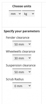

There is an online calculator to help measure this (see screen shot attached) But for it to be accurate it is asking for some measurements, would you have any idea?

Here is screen shot of the info needed for the tyre calculator on wheel-size.com
Does anyone know where to find this info for the Ducato?
