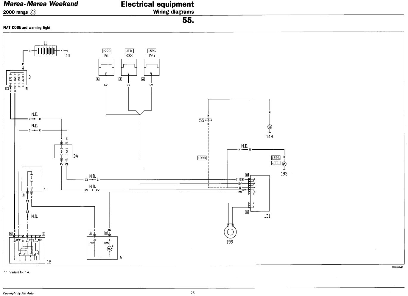

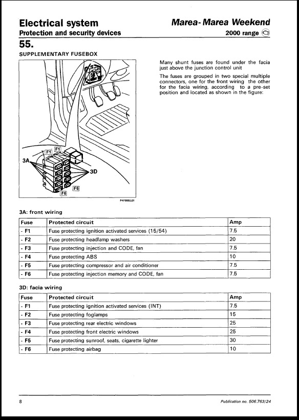

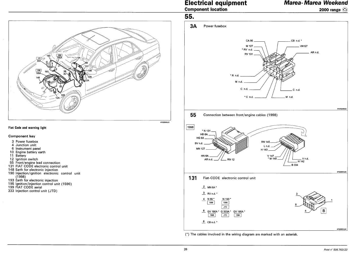

Now cant find this in the search as to which fuses/relays etc to check, as the cars not at mine i want to go prepared with a list of stuff to check. Here's what i've found, although only thing it tells me is which fuses in the dash to check, i'm not sure what relays etc.
If i've missed something from the Key Thread, please point it out.
Images from the marea manual as cant find the 20v wiring in the Bravo/a manuals.
you will probably fix it by giving the codebox a good wiggle (131 on diag), also wiggle all the wiring around it, and thump the ignition switch, its usually a bad connection at the ignition switch aerial (199 on diag) or the codebox.
an orange light suggest the immob has power, this is confirmed by the wiring diagram, it was only the system2 models that can illuminate when the power fails, so i do not think the fuse is a possibility.
