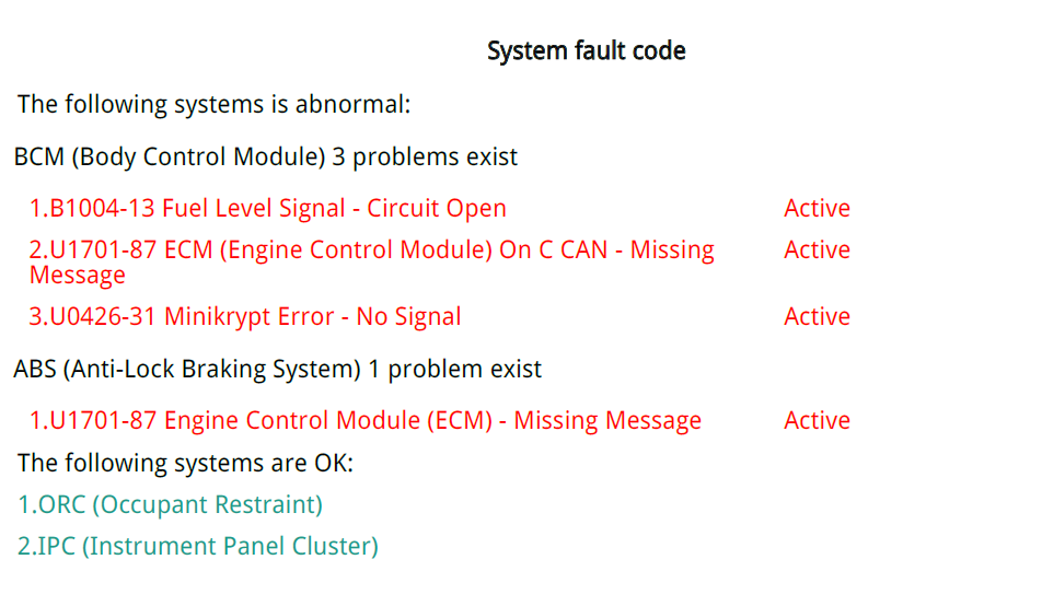

Thanks, the tool is fairly new but I will try find latest updates. I can see other modules but the ECM, see attached. I feel that certain functions in the ECM are not powered ABS and BCM modules have missing feedback from ECM.

Can bus errors may be a broken wire or poor connection.
Minikrypt I think is related to immobiliser side.

The x431 lists full coverage of Veleo TU3 modules and yes the car is not running right now it cranks but no idle.

It is not going to start when the imobilser is preventing starting (the car padlock symbol) and minicrypt code

I think there's something wrong inside ECU, it's blowing fuse of the main relay contact. The plot thickens :unsure:

I have just learned that the ECU is shot, its blowing main fuse so a looking for replacement and I see Cetroen C3 has the same type and model. Are they compatible ?
