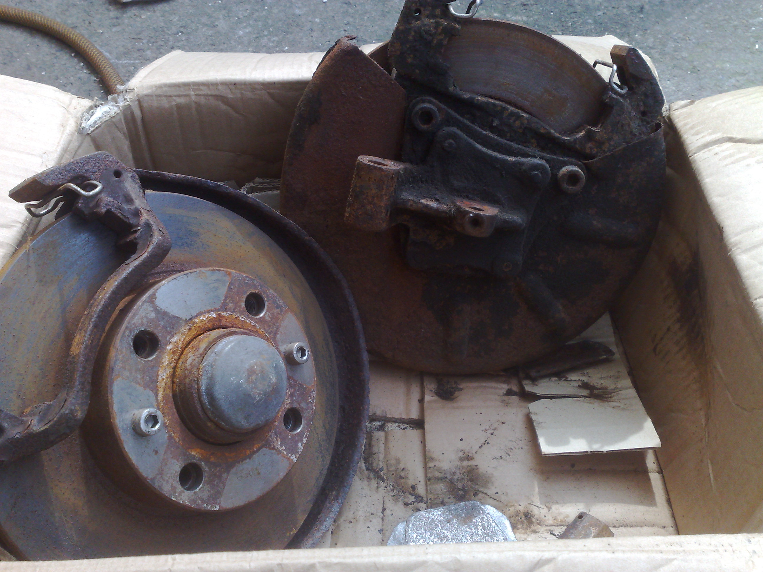

So having read that, he's made up a custom mounting plate for the caliper, on an UnoT is there a bit behind the hub like that bracket? I ask because i know a guy who is gonna get me the bits i need off an unoT so i need a proper description of what i need him to get off it.
So atm, i need the hubs and the carriers.. which are the next bit that comes off after the hub??
Yep, UT's have the caliper adaptor bracket on them which is attached to the stub axle. Using this and an UT rear hub and disc should align everything up nicely. Another way you could do it is, use Tipo 240mm front discs and the 'cento' rear hubs with an caliper adaptor bracket like I did on my 128. This adaptor obviously is slightly different to the one on the UT. The advantages of going the UT rear hub way are, wider track by 12mm and piece of cake to do (if the adaptors are available).:)

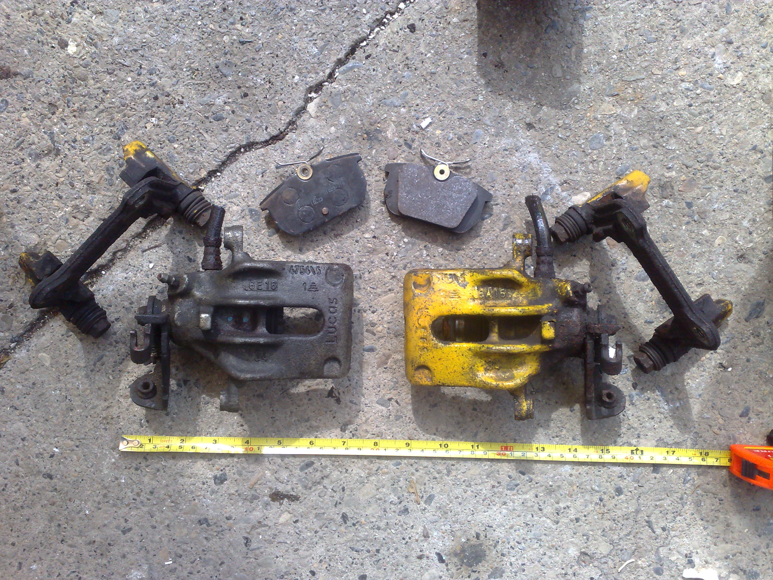

EDIT: Ok Jamie, it would seem your right.. One is yellow at least anyway, have this wierd memory of you giving me some UnoT rears and never really looked at them.
pic of calipers:
Not sure what the discs are off but they seem the right size for the calipers, they quite obviously aren't the discs the calipers were on though
