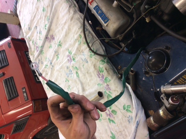

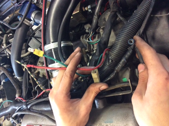

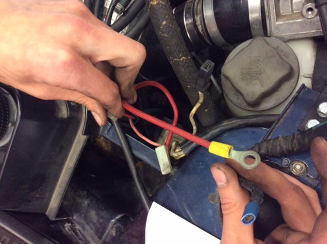

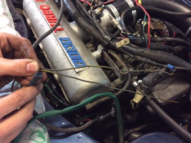

From the main cables that comes from the box (black one) there is a few leads that we can't get to go anywhere.
A red and a green (male) and one blue (female) and a white (female)
anyone knows where this goes?

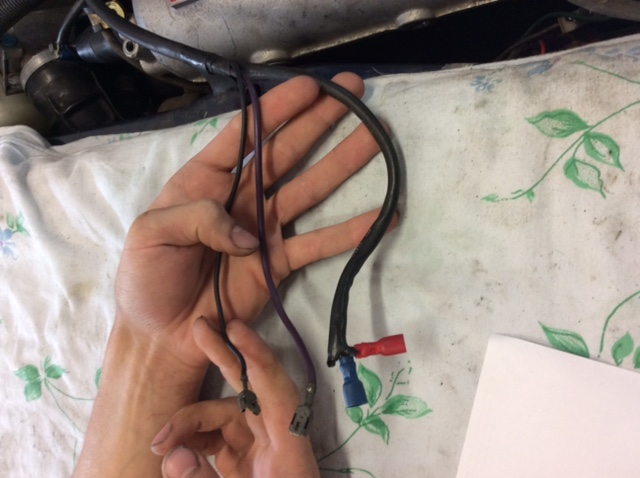

From the relay connected to the fuel pump there is one large red, and a small red cable, and a small pink cable and a white one (female)
and on the end of the main cables (from the black box) a blue female
This big pink cable we do believe was part of the main cables from the X1/9 before we started the conversion, but still wondering if it needs to be connected anywhere?

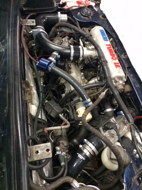

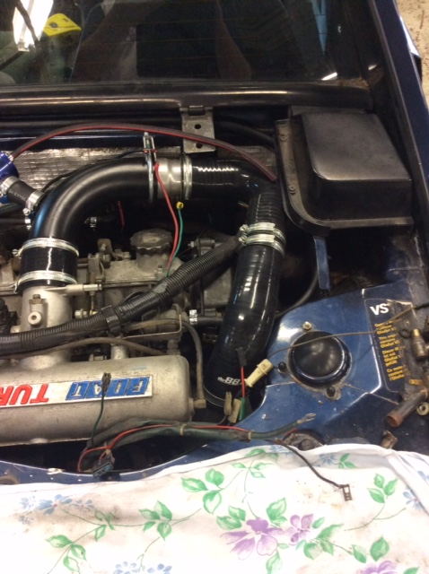

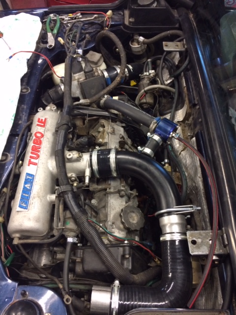

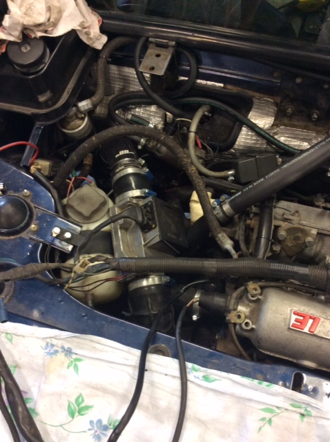

pictures what the engine looks like and where you can see the cables.
as I said any info and help would be greatly appreciated as we are stuck at the moment

What are you using as reference information?
I'm looking at the Haynes Uno manual that is commonly found online, chapter 13, page 88, the microplex wiring diagram.
The first thing that you should check is if the optional anti-theft relay is present. If the anti-theft is present or has been removed, you may have some non-original wires mixed in there. That would explain the dodgy connectors.
The pink cable connects to the coil in a standard X1/9. I think it comes straight from the ignition switch, but I'll have to check it.

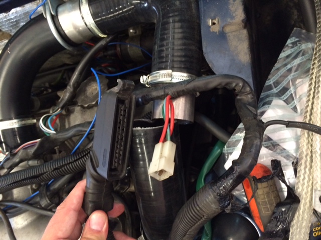

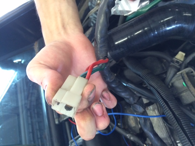

From the Microplex box, in the bundle of cables there is a connection with 4 cables, 2 reds, 1 green and 1 light blue, but it only have "outs" for 3 male connections, We can't get our heads around to where these ones are going.
Any kind souls on here who might know where?
many thanks

Hi,
What do you mean by "microplex" box?
The best approach, as hs been suggested before, is to disconnect the battery and unplug the Bosch ECU (big rectangular plug in your picture) and then use a multimeter set to Ohms to check continuity. Pick one of your unknown wires and attach to one meter lead. Then touch the other meter lead to each contact on the Bosch plug in turn. A reading of less than 1 ohm is continuity. Don't stop at the first pin you find, go through them all. Write down the wire identification (put a bit of tape with a number on each one as you go along) and what ECU pin(s) it connects too. Post the list here and we will do some detective work. If a wire does not go to an ECU pin try to follow where it goes.
Robert G8RPI.
