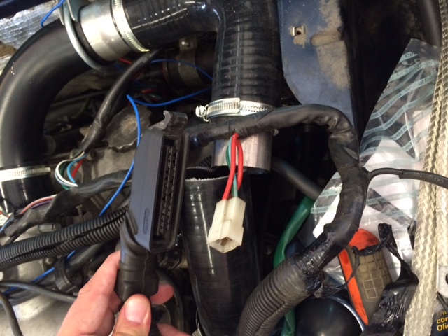

I'm doing a Turbo conversion on my X1/9 using a Uno Turbo 1,3 engine.
We are having a small problem that we need some help with

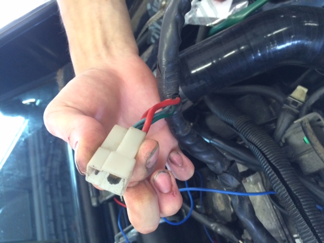

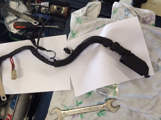

From the Microplex box, in the bundle of cables there is a connection with 4 cables, 2 reds, 1 green and 1 light blue, but it only have "outs" for 3 male connections, We can't get our heads around to where these ones are going.
Any kind souls on here who might know where?
I've posted this on the X1/9 page, but since this is a Uno Turbo engine I'm using this as well.
many thanks
Uffe

Hi Uffe, the green cable from the Microplex ecu is the digital boost gauge signal so is presumably redundant in your application so don't worry that it doesn't connect to anything on the other side of the 3-way connector block. The red cables are both ignition +ve, one feeds the ecu, the other feeds the ignition coil. The light blue cable is engine rpm signal from the ignition coil for the rev counter.
