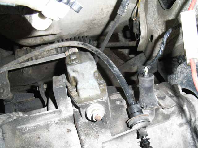

Is it this cover
The pin doesn't go through the tin cover, but taking off the tin cover gives access to the selector rod. That was real helpful for me as someone had been in there before and taken it apart. They left the central collar out so I had an absolutely hopeless gear shift mechanism that would not sit in the 3-4 gate. I pinched a collar from my donor car and it was all good. But you didn't want to know all that did you!! It was all thanks to alexGS that I found the problem.

I am a bit unclear about where the leak is coming from. On my Unos there is a little tin cover the comes off the top of the box. If the leak is coming from there that will be an easy fix. I think there is a gasket there. But to be sure a pic would help. I have had mine off to check the top of the selectors.
Is it this cover....
Hey there,
Thankyou for your reply. Yes, my cover looks exactly like that one, it is goldish in color too. I have had the cover's gasket replaced and sealed etc. It is definately leaking from the back where the pin enters just below where the cover fits on. In the front (on your photo) you will notice a nut which I am suspecting is holding that pin in place. I am suspecting that at the back side where it turns, there would be some sort of o-ring that has gotten worn out.

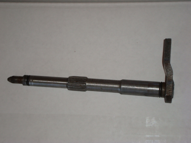

Lucky I have a gear box all pulled apart (my parts gearbox) so I have taken a photo of the selector shaft which clearly shows the o-rings.
You might also want to check that the oil can properly drain out of that part of the gearbox as oil shouldnt be able to simply be sitting there to leak out.
As Robin has pointed out be careful not to drop stuff into the gearbox. This shouldnt be too much of a risk as the parts are rather large (one big metal thing and two large springs). Also as Robin has pointed out you have to be careful it doesnt all come flying out of the area as soon as you remove the shaft. There is a small amount of tension in the area (the two springs are what keeps your gearstick in the middle).
So when removing the shaft you should probably do the following things:
Undo the nut
take a note of the orientation of the other end of the shaft
while holding the internal parts in place, slowly remove the shaft
might be a good idea to follow the shaft with a piece of thick wire or a small rod of some kind just to hold everything together while you remove the shaft.
Putting the shaft back in again is a bit tricky as the splines only fit one way, you will just need to make sure its oriented in approx the same way as it was when removed and jiggle it until it slides in (don't force it).

Thank you so much for your help and that photo. It gave me courage to undertake this DIY (distroy it yourself) job with a bit more confidence. When I took it out, I immidiately followed it with a thick piece of wire to group all the parts together, walked to the spares shop, got both o-rings for less than 1 Euro and replaced the whole lot again.
I did get a bit worried in the end, but remembered you mentioned it might get tricky at some stage. It is all together now, and the leak seems to have stopped.
