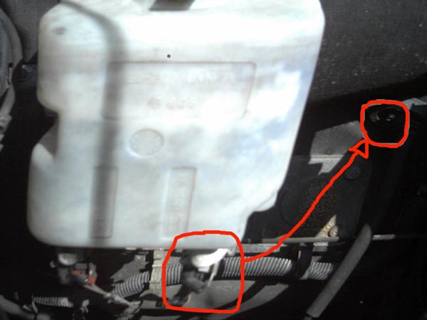

right, hope this image posting malarkey works ok.
I have circled the 2 pipes (one coming from each motor(I presume one is front and one is rear?)) and also circled another area where I believe a pipe should be to feed the rear washer. Not sure where the front pipe should go.

I couldn't tell from your pictures where exactly the pipes should be. I have a mk1 which uses the 'hot water' style washer bag, so not really much point in taking a picture of it!
However, I also have a later mk1 solid washer bottle that looks similar to yours. The motors push into the bottom, and at the front/ underneath each motor is where the electrical connectors go to.
If you feel BEHIND each electrical connection, there should be a solid plastic pipe about 1.5cm long pointing downwards. It's to these that the flexible plastic tubing connects to for the water feed to the front and rear screen washers.
To check the front screen washer piping, find the washer jet, then see if the there is a pipe attached. If you can find it, then trace it back towards the washer bottle to see where it goes.
The rear washer pipe, from memory, comes out of the bulkhead on the passenger side of the car. Look at where the speedo cable goes into the car, and you might find a pipe going in next to it. If there is one, then that is the feed for the rear washer jet. On my car it then runs through the roof to the rear hatch.
Bear in mind mine is a mk1, but it could well be similar on a mk2.
However, on both mk1 and mk2 if you disconnect the pipes from the motors then the bottle just empties itself out. Yours are either blocked, or maybe someone has fitted blanking plugs to the motors?
Hope this helps!
Chas
Just had a another look at your picture Timm. It appears that the pipe for your rear washer is missing!
I've circled in red where it should go into the bulkhead. You can see that there is a small hole next to the speedo cable, and this is where the rear washer pipe should fix to.
The other circle shows what appears to be an 'L' pipe that should connect the motor to the hole in the bulkhead with a flexible tube.
I've no idea of your front washers as it's not clear to see. Perhaps you can try what I suggested above to locate the pipe for it.
By the way, I would suggest pulling off the 'L' pipe to see if it's blocked. If not you might find that the motor itself is gummed up from inside the washer bottle.
Perhaps your best bet is to either find another mk2 Uno to take a look at, or see if you can find one in a scrapyard to take notes from.
Best of luck, and let the forum know how you get on :)

Thanks everyone for that information. A pet shop!! I'd never have thought of that!
The front washer motor is actually just to the left of the rear one and I think it's a bonnet off job.

Well, I bought 2 metres of air line hose in a rather fetching luminous blue from the local aquatic centre and fitted them where I thought they should go.
Et Voila!
Working front washers!!! (y)
