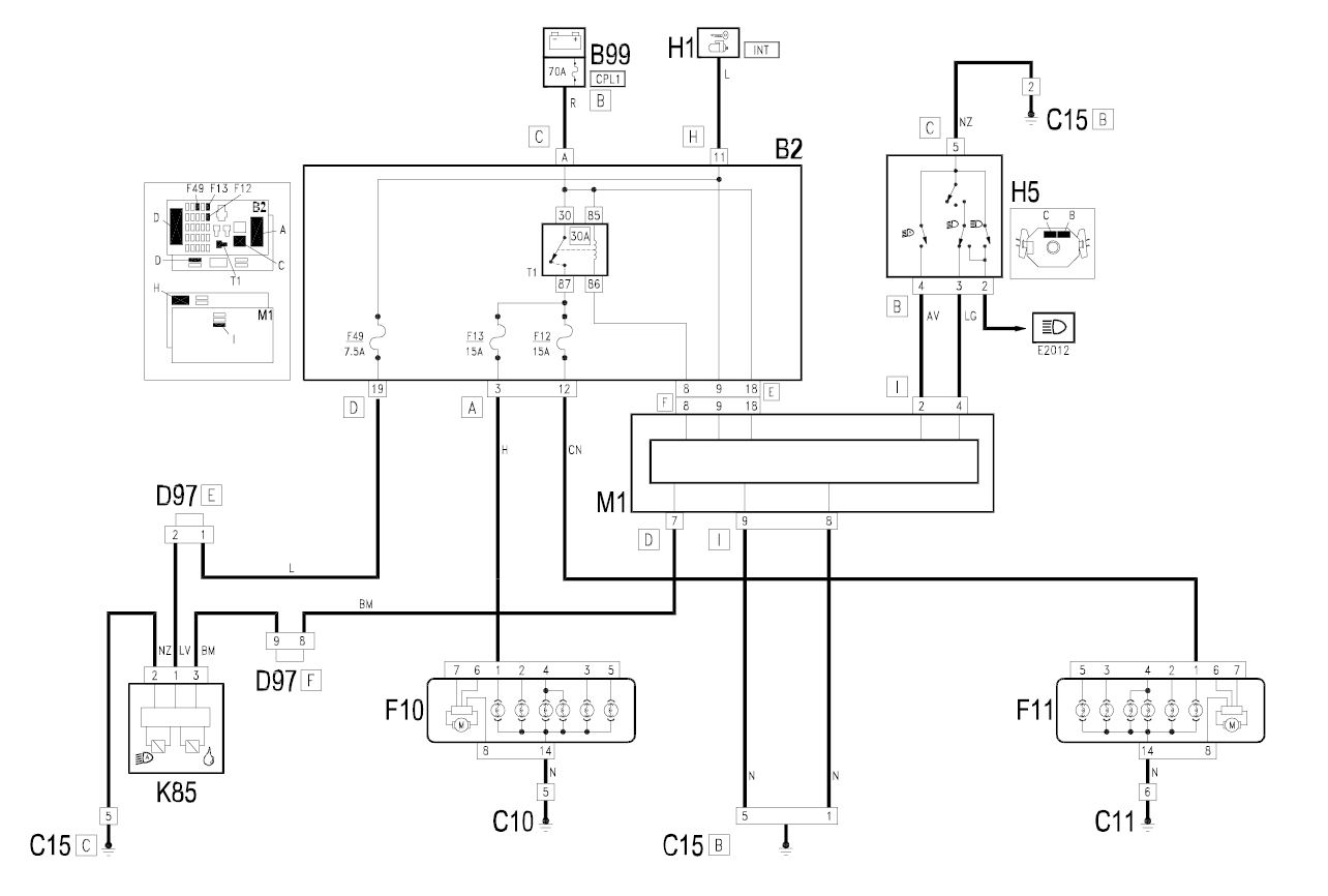

Check that you have power and earth at the headlamp connector when switched on. The dipped headlight supply wires are on pin 1 of each connector, and should be grey for the left lamp and orange/black for the right. Both earth wires should be black, and go to pins 14 of the connectors.

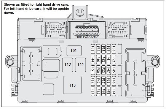

You say that you've checked the fuses (F12 and F13 in the dashboard fuse box), both dipped beams are also supplied by relay T01 in the same fuse box.
Diagram of the fuse box below shows how it's fitted in a right hand drive car, for left hand drive cars it will be rotated 180°
