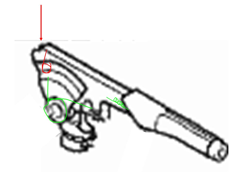

If the button pulls out easily, to lower the handbrake lever to the floor (for rotating the seat), then it is unlikely that lubrication is the answer.
There are three springs:
Two easily accessible (one to pull the knob back in, after it has been pulled out to drop the handbrake flat to the floor, and one on the door side of the mechanism, to pull the handbrake lever down when it is released). These could probably both be replaced, but they would not cause your problem.
The third spring, which forces the ratchet teeth together and pushes the knob out, is most likely the cause of the problem (as Pat stated). This is internal to the handbrake mechanism, and would cause the problem if it has either broken or slipped. Unfortunately this is difficult to see or get at. The only way I can see to get any access to it is to pull the knob out and lower the lever to the floor – the spring can then be seen as shown in red on the diagram. If the spring is broken, then I don’t think it can be replaced, as the handbrake would need to be disassembled and I think it would need specialist equipment to disassemble and reassemble.
