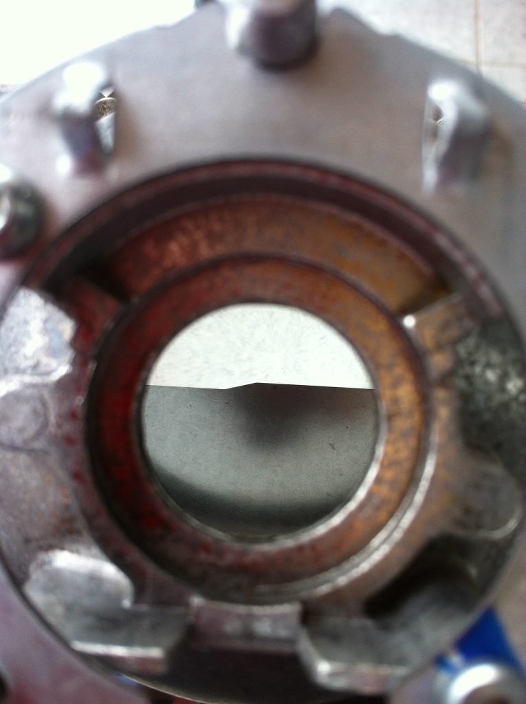

Take rubber dust cover off and remove bulb from dipped beam projector and peer into it. You will see a baffle inside as shown in 1st photo except mine is positioned for LHD, yours will be reversed. This is what you are getting at to reverse like mine. It's position on bottom of projector does not look logical but bear in mind that projectors turn beam upside down!

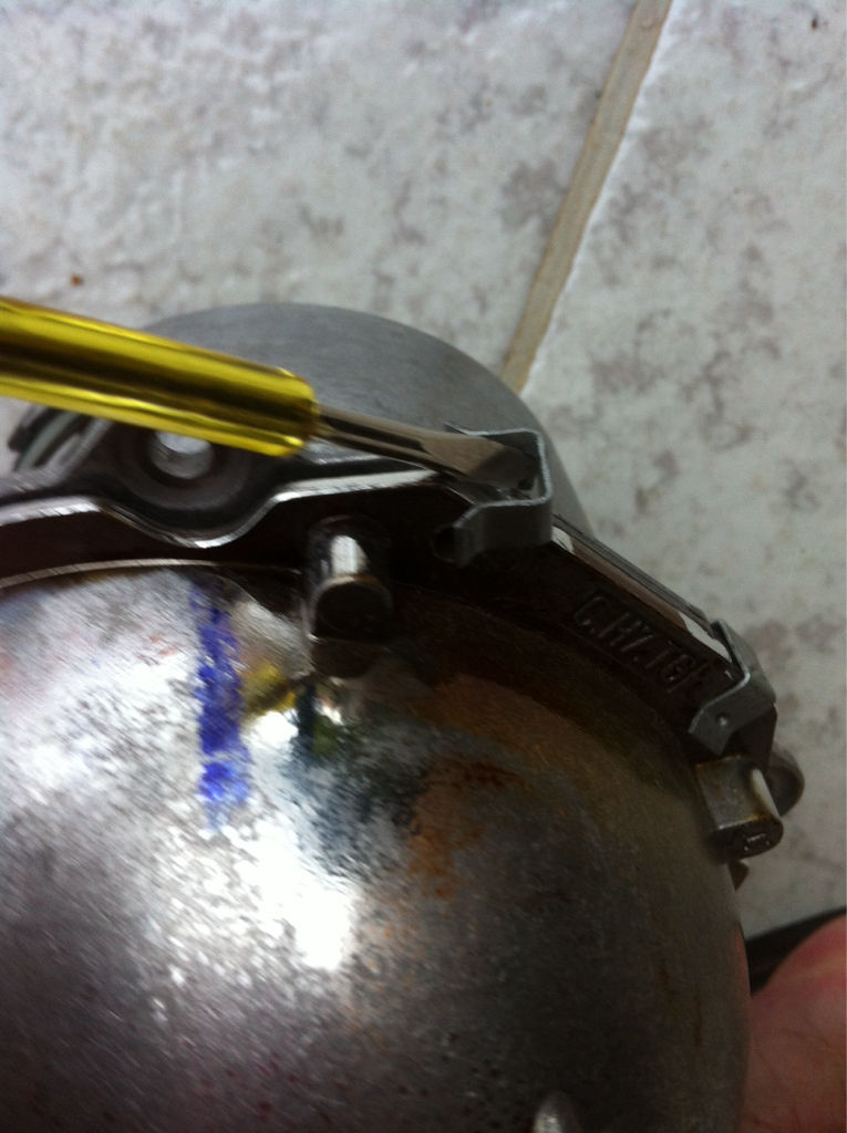

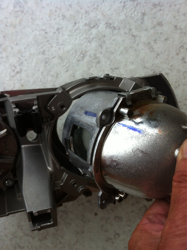

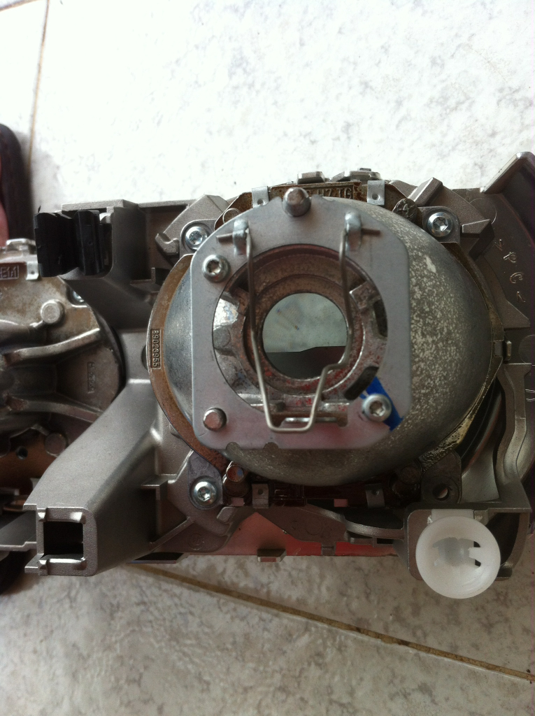

2nd photo shows 3 x T20 screws which have to be removed so that projector can be pulled outwards in headlight casing. It is not possible to take it out completely but it can be inclined within casing to work on it (3rd photo shows this except it is happening within casing). I used a felt tip pen to make an alignment mark on projector and lens unit, just in case! Unclip 4 x spring clips shown in 4th photo using a thin bladed driver and a thin nosed pliers. You will have to rotate projector to get at them all. This will seperate projector and lens. This joint houses the baffle. You will not see baffles as clearly as in my 5th and 6th photos as in confined space it will not fully pull apart. You now have space to pull out baffle, reverse it and slide back in. Re-assemble, making sure clips are properly seated in little holes. Squeeze beforehand with pliers if they have spread while removing. Re-seat projector and replace 3 x T20s. Replace bulb and dust cover. This work took me 30 minutes for first headlight and 10 minutes for 2nd! (Total including bumper and headlight unit removal about 2 hours).
