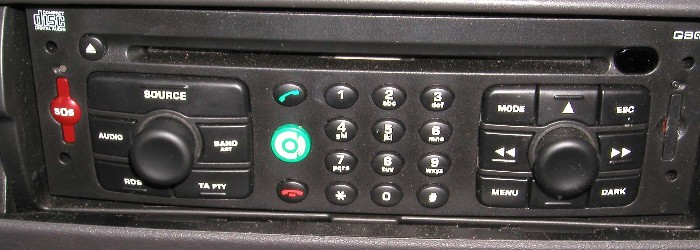

A lot depends on whether the car originally had an RT3 unit fitted. Does your car have a round black panel below the gear lever with a rotary selector? Labelled "Main", "Nav", etc.? Or does it have a coin holder? If the latter it never had SatNav or a car phone.
hi,thanks for the reply
yes the car has both actually,right under the gear stick is i coin holder but just to the left of that is indeed like a dial you can turn that says nav/tel etc....
That's a new one on me. Usually it's one or the other - either the black selector or a blue (?) coin holder. However, sounds like your car had SatNav at one point. Without the RT3 unit the display won't function (so no error messages). Do you have the colour display between the speedo and rev counter? Or the monochrome one directly above the RT3 slot?
The RT3 is much more than a CD unit, it's a SatNav, a phone, a radio and - with the navigation disc removed, a CD player. Hopefully the wiring behind yours is still compatible with a replacement RT3.
That e-bay one is very cheap - they usually knock out at £220 or more. I don't even want to begin to think of the new price. Certainly into four figures.
Probably means coin holder in the pull out drinks holder or ashtray? can't check at the mo as the missus has gone to work in it but I know ours has got one somewhere!
