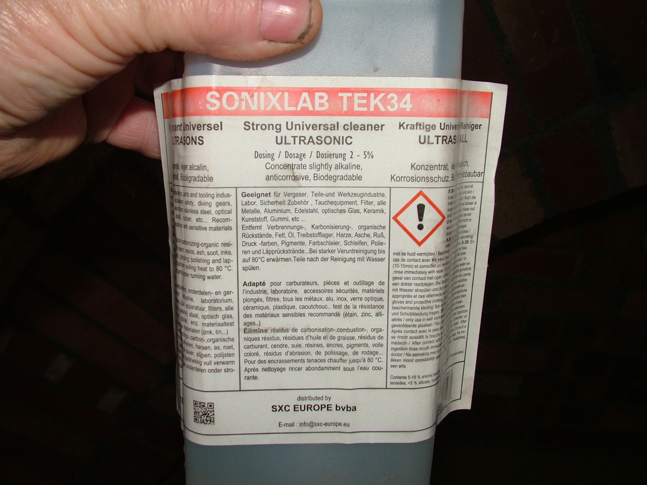

I use this for Bosch diesel injectors with really hot water, don't lose the ceramic ball valves. Soak in diesel afterwards to prevent rust.
I got spares from Darwen Diesels

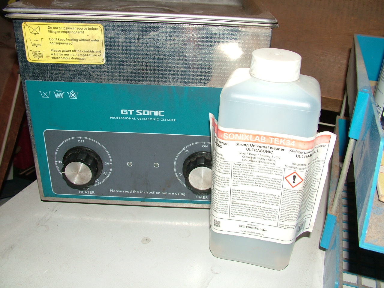

Generally I reuse the solution a few times and as it in a gauze tray all the dirt falls to bottom of tank away from the parts you are cleaning. I put an old tea strainer wired to the side for smaller parts. If in a glass jar it means the parts are dancing in their own muck.
I found as long as the water was hot and the mix of solution was about correct then it did the job fine.
The TEK 34 stuff wasn't cheap but seemed to do the job well.
