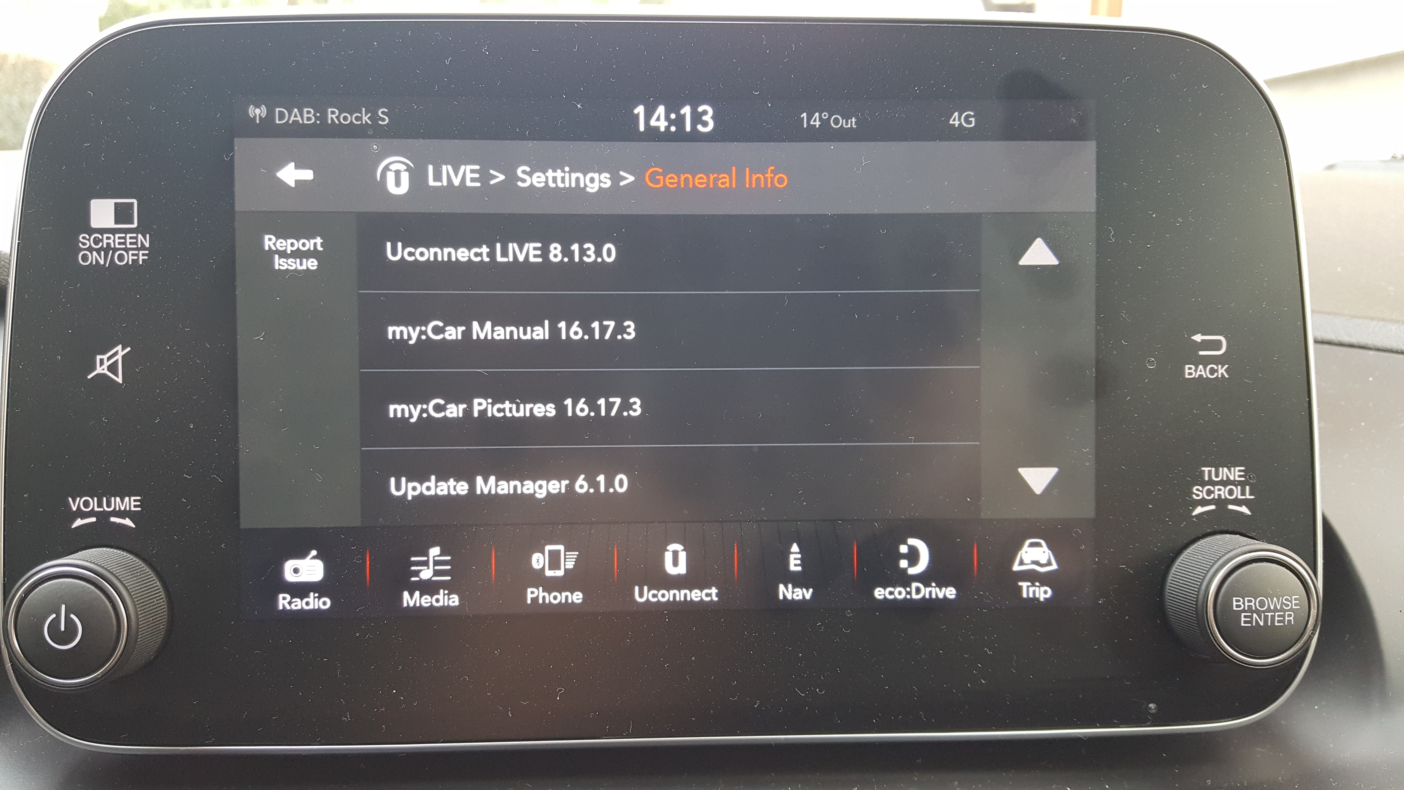

Hej, what program versions do you have for your radio?
This is from my car (picture attached)
