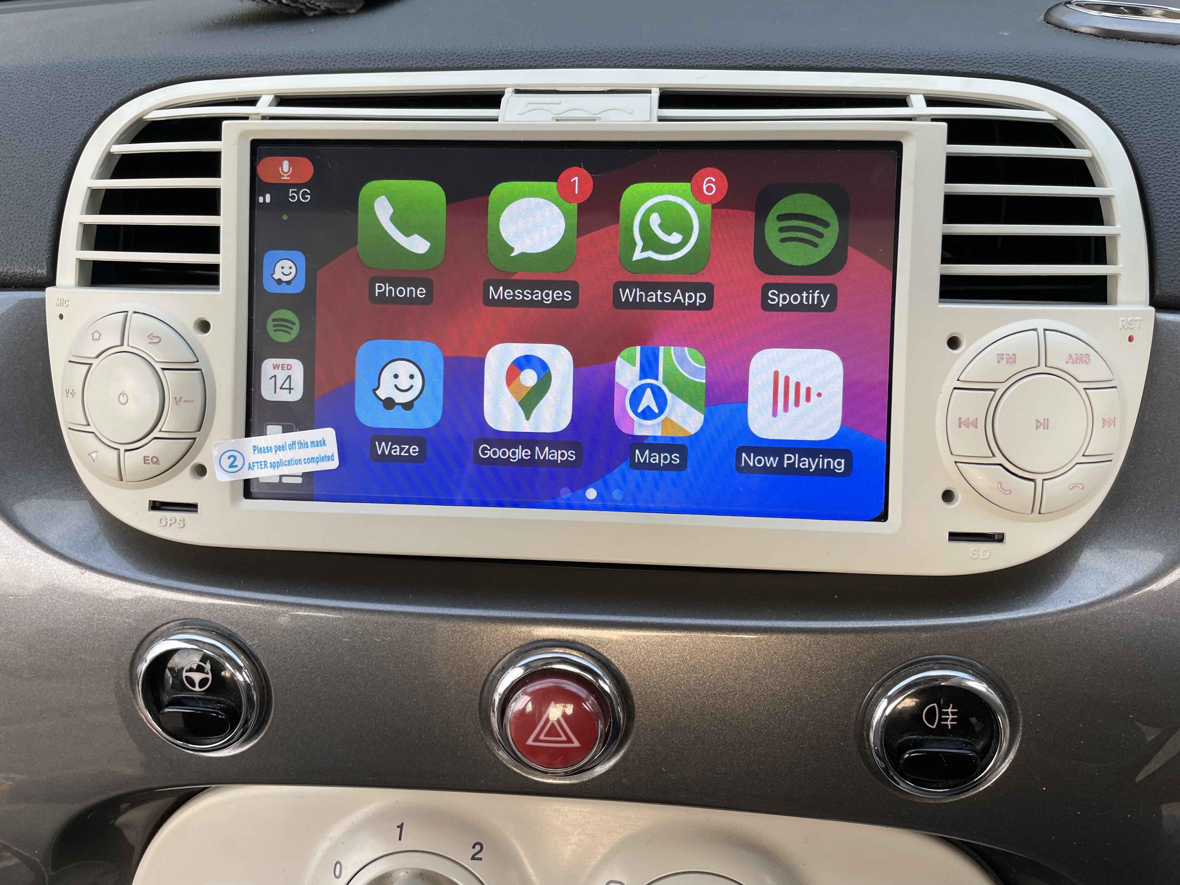

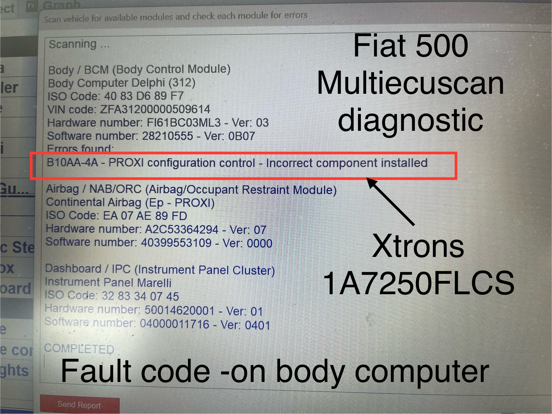

Installed an Xtrons IA7250FLCS to a 2010 Fiat 500 and disconnected the blue & me module. After several proxi alignments all was ok but canbus would error on multiecuscan as pictured.

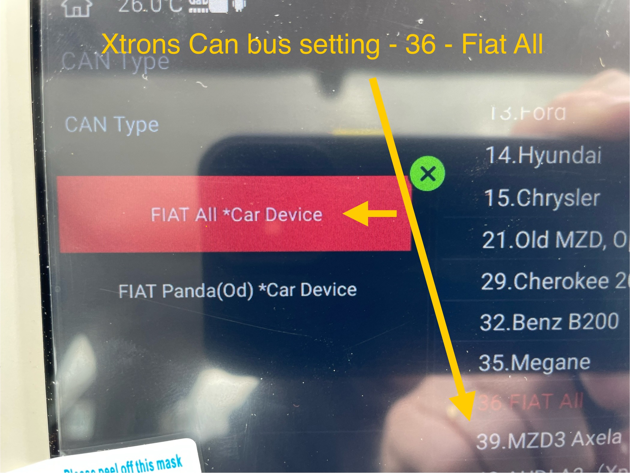

After selecting canbus number 36 all Fiat’s in the Xtrons settings menu and then manually mapping the steering wheel controls, mileage continued to flash.

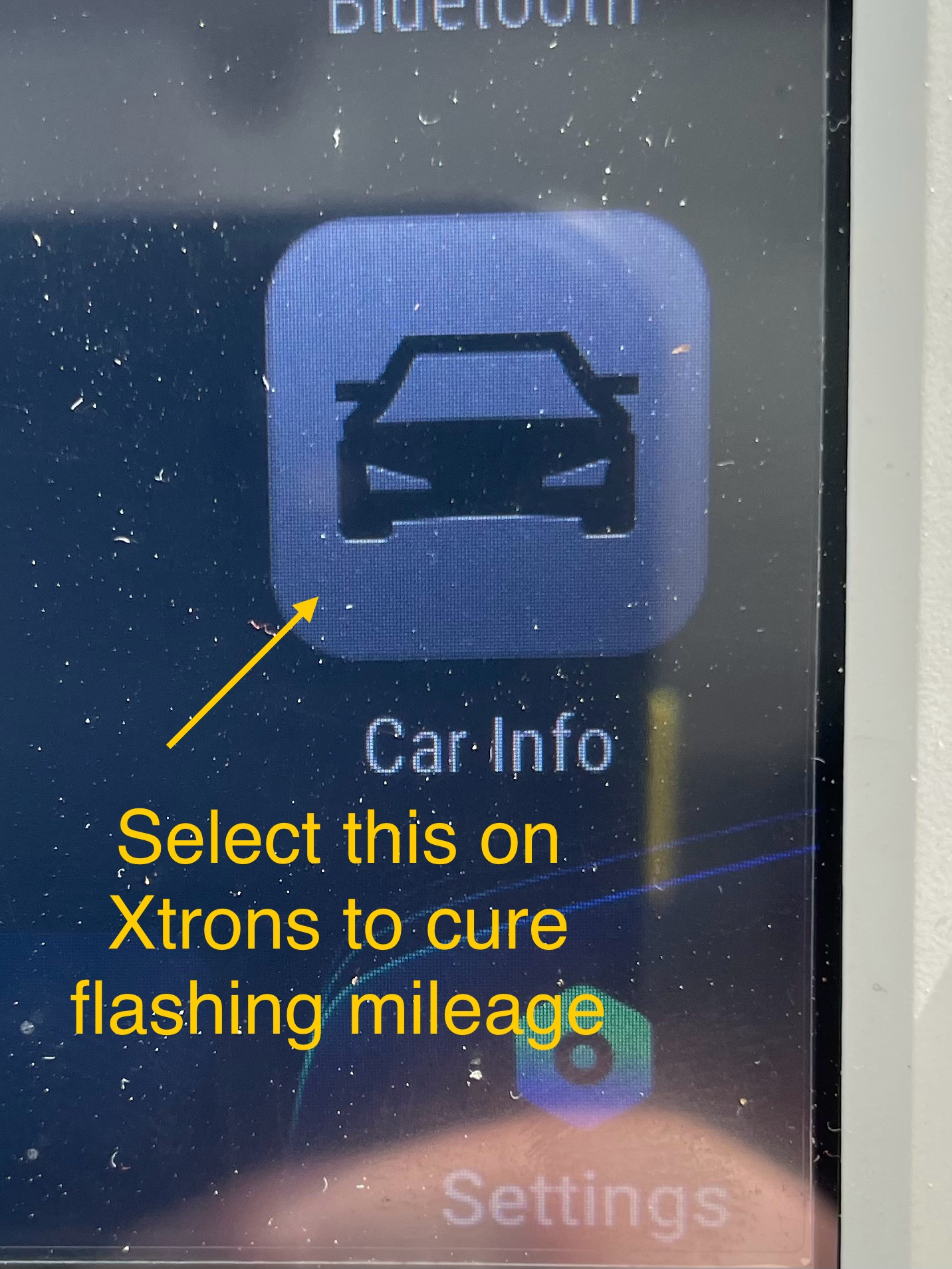

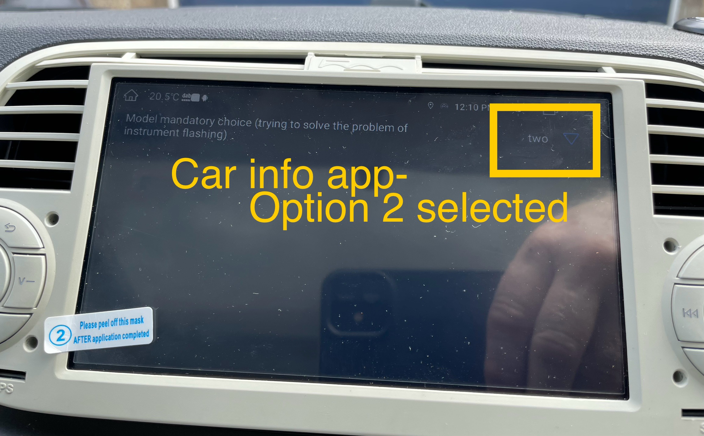

Then finally went into Xtrons ‘car info / resolve flashing odometer’ app then option 2 and after a few power cycles it’s fixed the issue and no more flashing mileage and all is good with the Xtrons unit 👍😁🎶🚗
