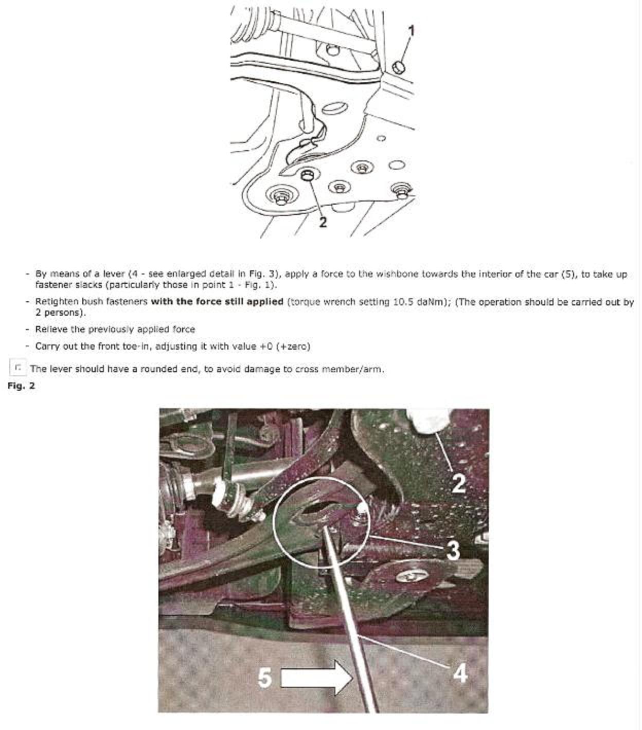

I've done about 300,000 miles in two Stilos, and the wear on front tyres were always weird. Both JTD's, so some extra load there, but the wear was often uneven. Suspension & alignment repeatedly checked, just gave up worrying about it in the end.
There was a Fiat Service News bulletin about front tyre wear.
I don't understand how it works though, because having levered the wishbone out to tighten the bolts, the rubber bushes would return to their original position when the lever was released.
However, my Stilo used to suffer with front tyre wear, but after carrying out the procedure it was OK. :confused:
Thank you for this, will be putting on new tyres on front and having professional tracking done, not those that cost £15 :D learned my lesson , better to pay a bit more to have a quality job done. see what will happen then, just wondering if this can be used anyway or only when the problem is. After closer inspection with a digital tyre depth meter it looks that it is uneven, so im guessing my tracking is out now. Well you live and learn always.
