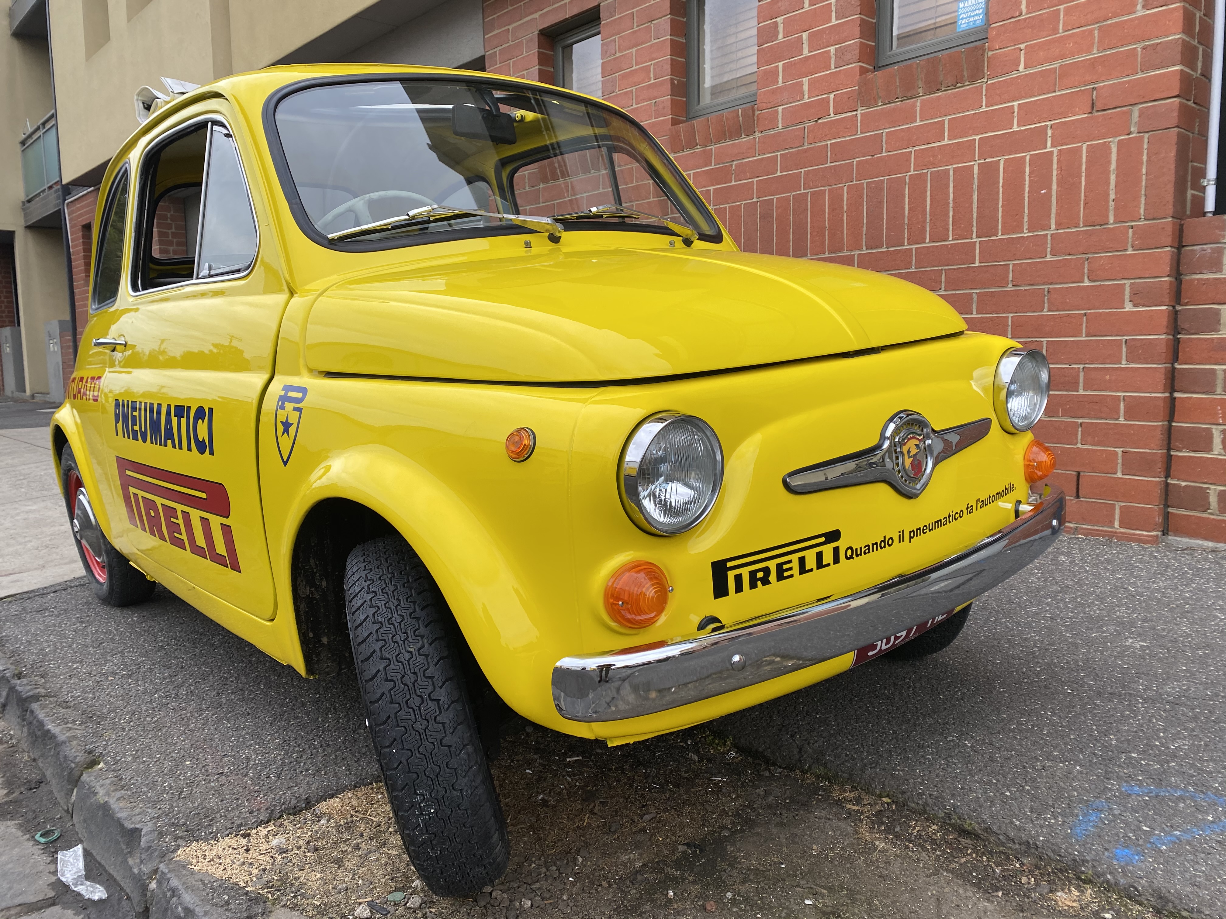

Hi
Out of interest this is our weeb page on the subject of tyre pressure.
It has lots of period fitment guides from tyre manufacturers. Of course including Pirelli who made the original tyres in period, and are making them again now.
