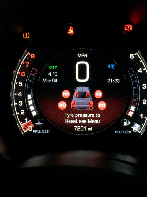

Hi does anyone know what the KO stands for next to the tyre on my 500. They tyre pressure has been checked and all correct but KO isn't even in the manual, any ideas would be appreciated it's a 500s 2015 thanks ImageUploadedByFIAT Forum1457133431.617273.jpg
Hi thanks for the reply they're usually green with ok next to them, it keeps alarm sound to alert fault, guess trip to dealer
Thanks for that I reset it in the menu and on my 3 mile drive to work it was ok so see how it goes, maybe the bad weather yesterday caused a malfunction.

This happened on mine a few weeks ago, all came up as KO. I couldn't find out what it meant either. Reset it and carry on that's all I did.
