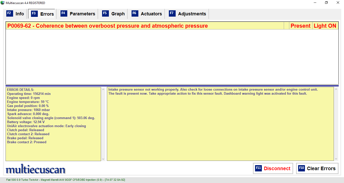

Im getting a P0069-62 error code on a fiat 500 twinair. Ive replaced the MAP sensor and still no luck. It seems to only appear when the engine is started.
See multiecuscan output below
Could this be an issue with the PCM?

Hello, have a look at my thread about a similar matter. In that case it was not the sensor but rotten wiring in the loom. Can you test the integrity of each wire in the loom by using some form of continuity tester?
James
