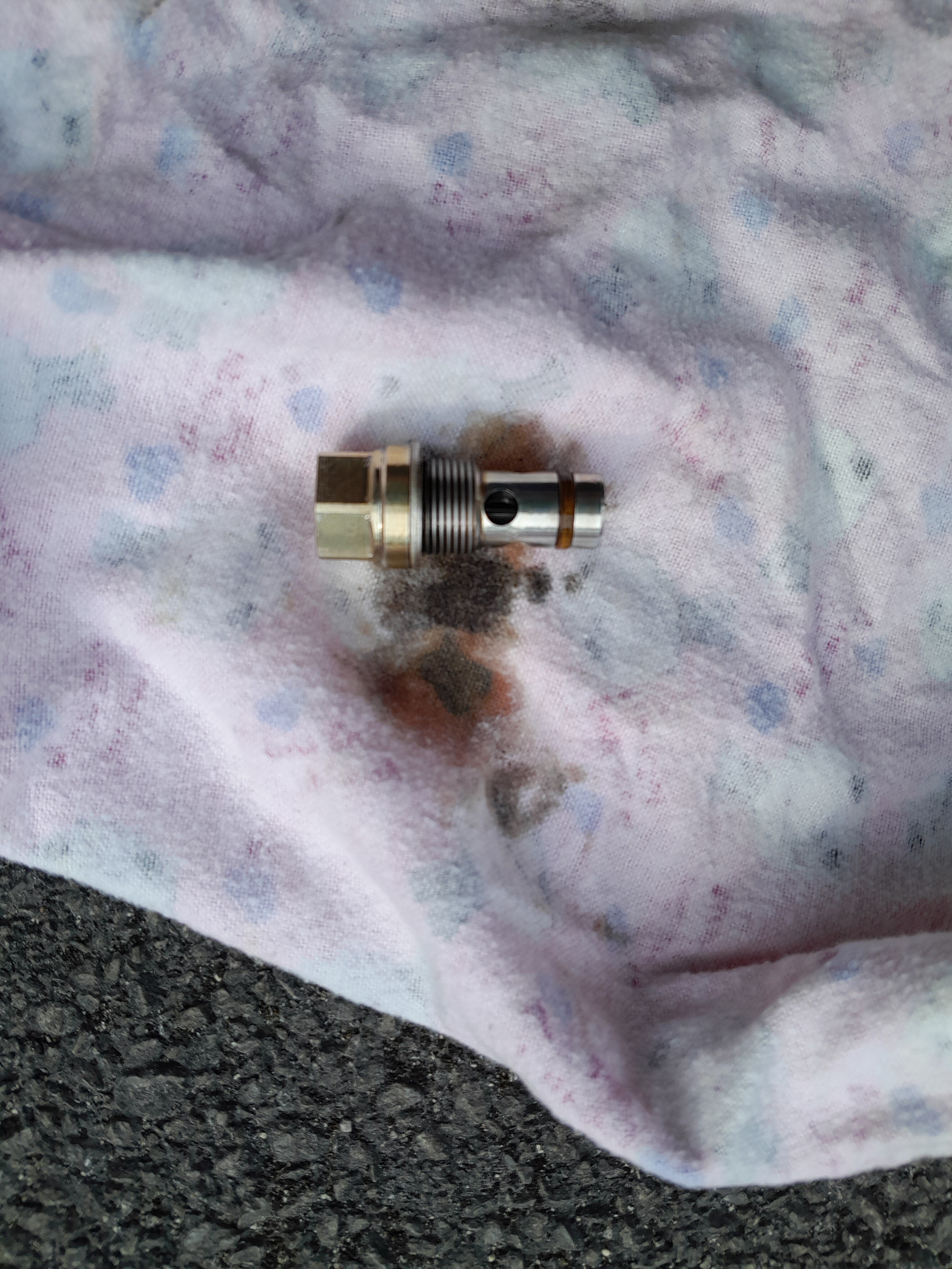

I have just carried out an oil and filter change on a 64 plate twin air 105 at 35000 miles. We have had the car for 7 months. I have now had a couple of issues with a misfire and engine warning light coming on and the Start-stop unavailable showing . However , the first 3 journeys of about 4-5 miles each after the oil change there was no problem . I managed to clear the engine warning light and clear the start-stop light by stopping and re-starting the engine and it has then run OK after 10 seconds of revving it up.
The engine was fine before the oil change but has always had a little stutter in first few seconds on first starting with a cold engine .
It seemed too much of a coincidence that the problem only started after changing the oil and knowing how important the oil is for the Uniair unit.
I have checked with the Multiecuscan and it has logged the faults as below.
I trawled through other forum threads on this topic area for ideas and can confirm the engine has had and 0-30W oil before and again at this oil change after only 5k miles . I have used Miller oil that I have also used in another twin air and it has been fine. I have also carried out the oil change reset in Multiecuscan . But what I haven't done is check the oil filter for the Uniair unit. Can anyone tell me where it is , or a photo please. I think if it was a spark plug / coil pack issue it wouldn't just disappear on a re-start or when the engine is warmed up. The spark plugs have only done 5k miles. But I will swap over the coil pack plugs and see if I can move the fault .
Anyone got any ideas, constructive suggestions
Thanks in advance
