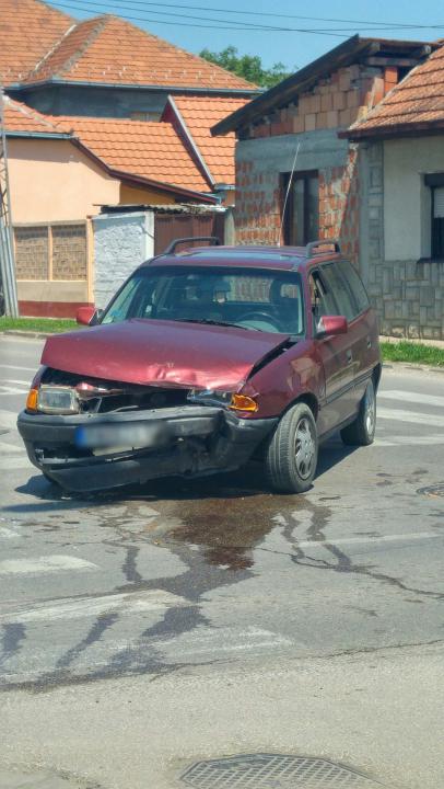

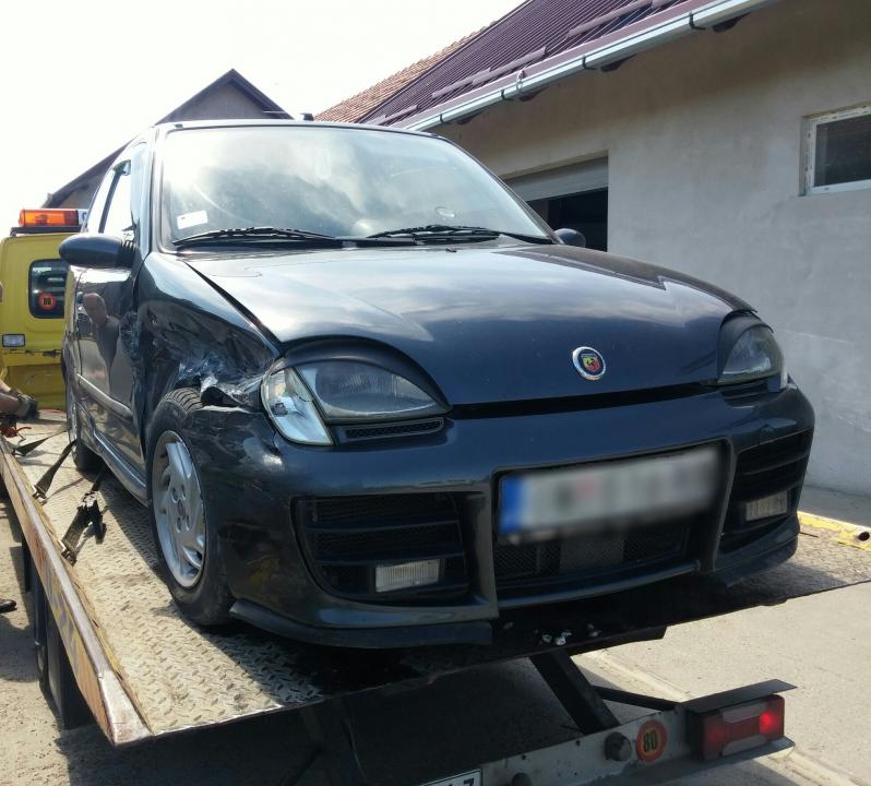

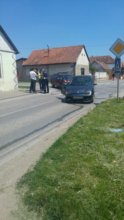

I had a car accident and my turbo project is on hold :(

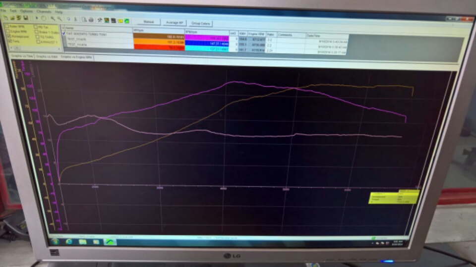

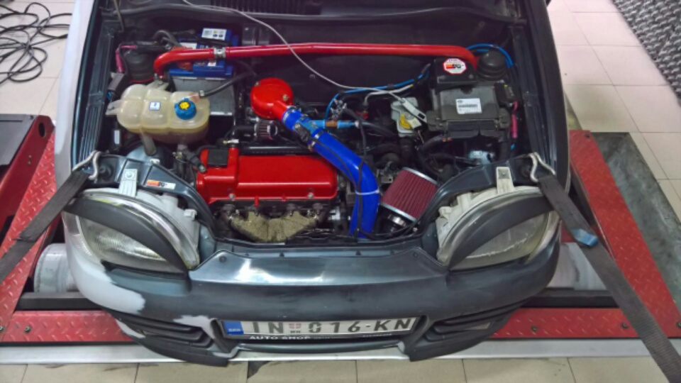

The turbo project will soon be completed, for now is 102HP :)
Special thanks to woj and The Black Box!

For a 1.1 MPI engine and moderate boost level (what is it BTW?) this is a nice result. 1.1 MPI inlet and valve are quite restrictive, forcing almost another 50hp on top of the factory 54 is not that easy.
Turbo boost is 0.9 bar (about 14 PSI). Turbo Charger starts to kick at 4000 rpm
