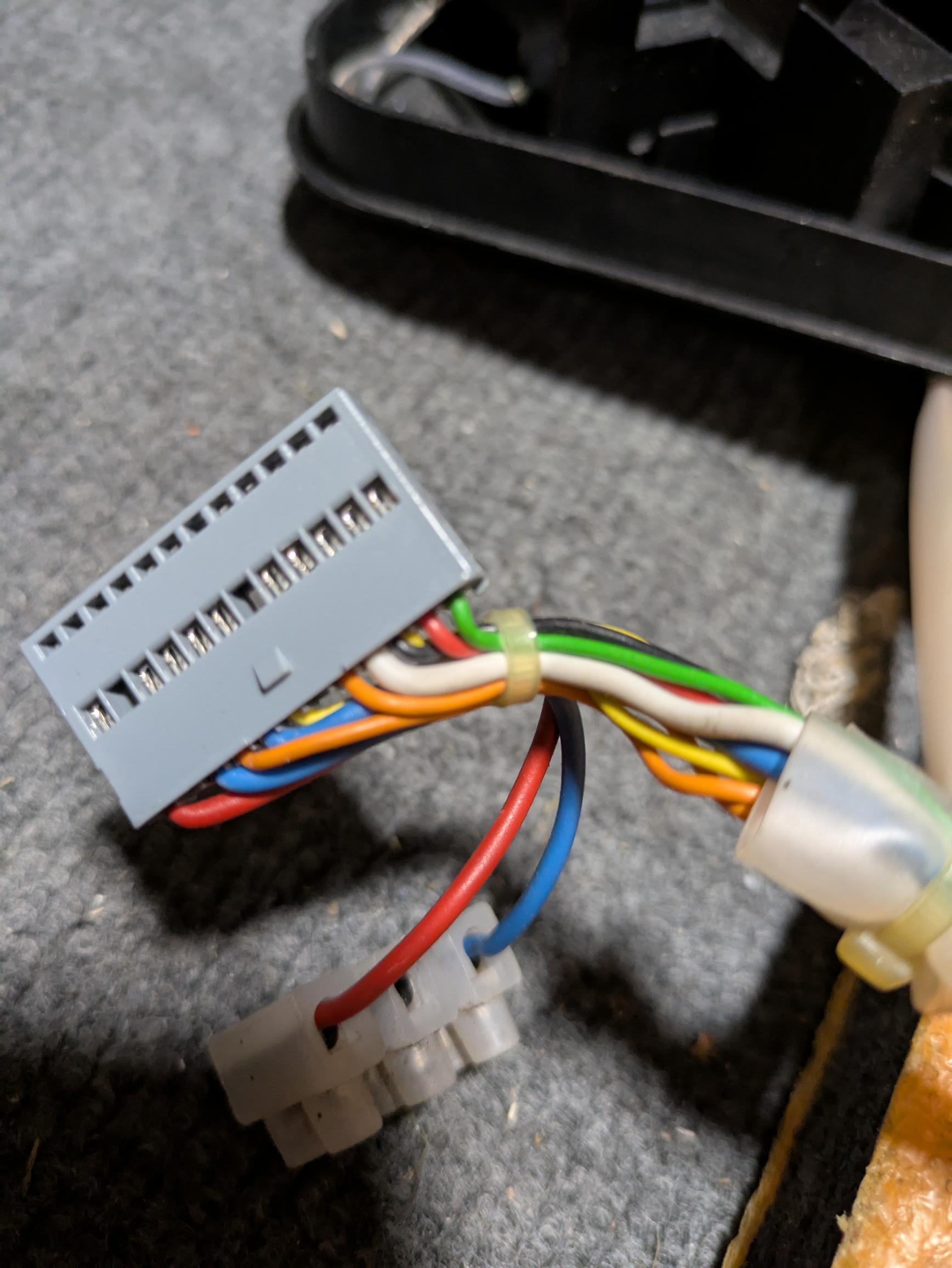

There are 3 wires that go towards the solenoid that come from the PCB.
Assuming i have taken everything off (i.e. disconnected PCB)
1) i think i would have to apply current at the connector onto the PCB
2) as there are 3 wires, it is not obvious which ones i should apply current to.

Can you show me?
The 3rd wire could well be a switch to signal back to the pcb that the solenoid has indeed actuated/moved (could be active high or low, i.e. referenced to the 12V or gnd).
If you've got a multimeter , use the resistance range to check resistaance of the various combinations of the three wires (and report back)
Can you show me?

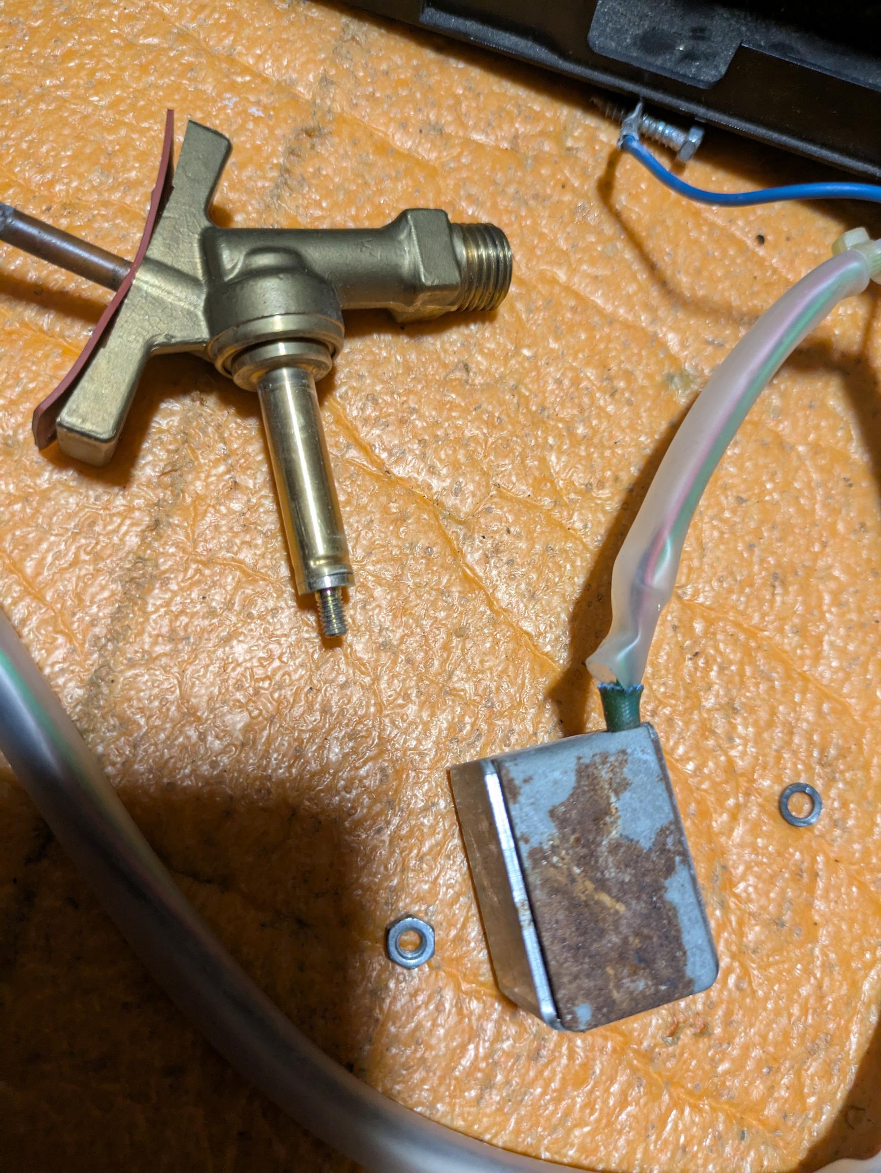

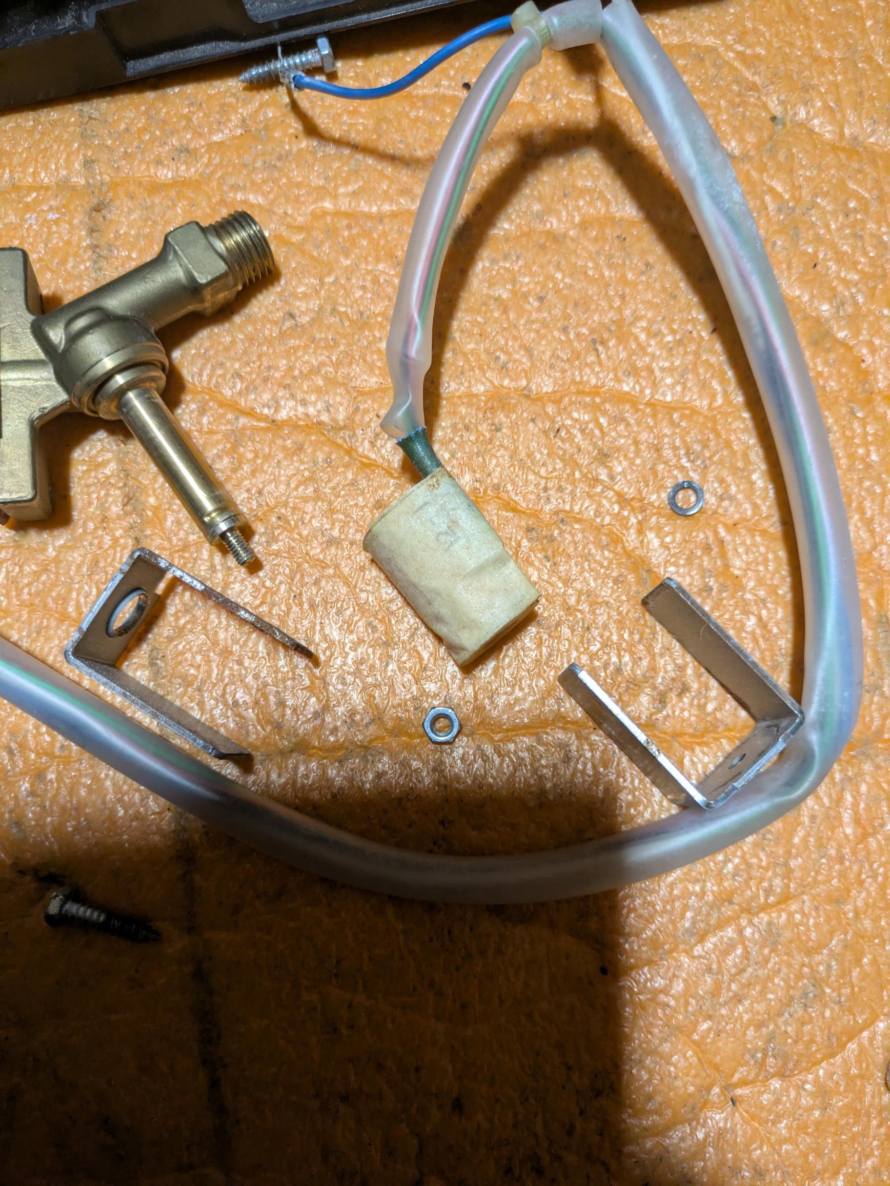

There is a red, black and green cable that is in that sheath that goes down to the solenoid.
Testing at the connector, i get continuity between red and black and no continuity to these to green.
So i presume current flows down red (+), and black (-) and green is the signal (which would be what you would guess anyway).
I am guessing that
a) the white block is the coil that get magnetised when current flows
b) the long thin brass bit that is inside the coil should therefore move internally when the coil is magnetised and open up the gas flow.
If i were to apply current down red and black from a battery, if solenoid was working correctly i should be able to look down the main pipe and see it open.
But if we are assuming this part is faulty, it won't move, and i won't see anything.
That would then imply (but not quite guarantee) i need to replace this part.
Thinking out aloud: if i were to leave the coil part off the brass part, and put everything else back on, once i turn on the controller, it should energise the coil. Is there a way to test that? As if it failed the test, that might imply the PCB was faulty.

I'm expecting some resistance (probably less than 25ohms, but certainly not 0ohms) on one particular combination of those three wires.
This would be the solenoid coil (the electromagnet element of the solenoid) , it must be present.
If there isn''t such a resistance found , then the coil is open circuit (i.e. damaged), or the final wiring to it is broken/disconnected.
Forget about current and the controller etc all of the rest of the system, you're simply looking for that resistance first on the solenoid.... it must be present to eliminate the solenoid.

I put the connectors back on and turned on the controller.
When i (quickly before the controller went to fail) put my steel screwdriver in the hole inside the coil, i could detect no magnetic field.
However, when i ran a magnet up/down/around the brass solenoid, there was no movement, it stayed shut.
I am thinking there are too many uncertainties/unknowns, and i am best off biting the bullet and getting a replacement water heater.
