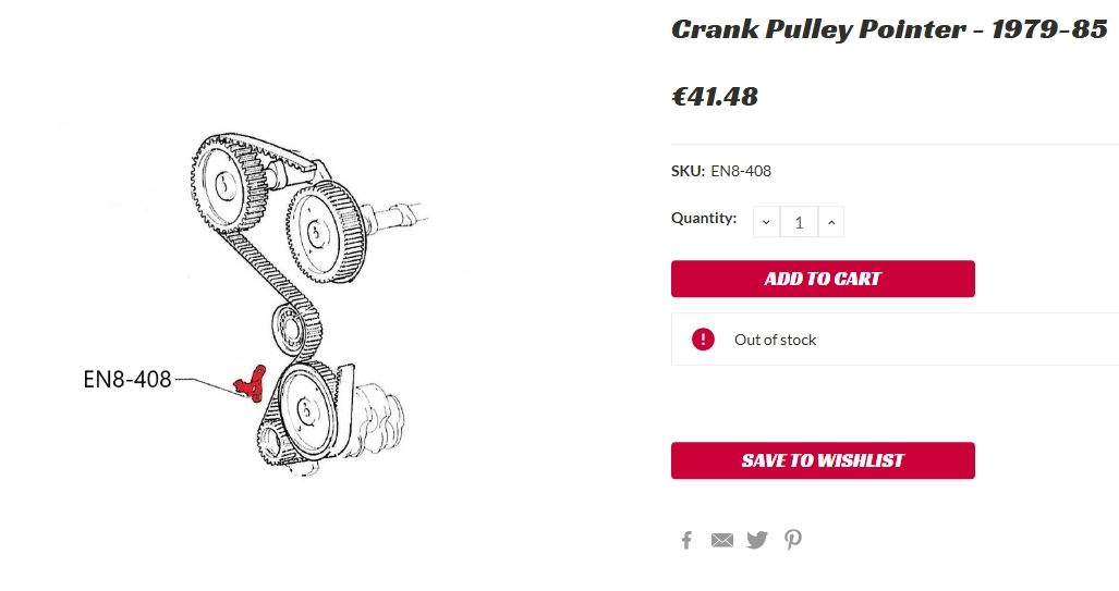

On the 2000 engine, there should be a fixed pointer attached next to the crank pulley at approx. 10 o'clock position, the pointer looks like this:-
(older engines had 3 lines/marks cast into the timing belt cover at approx. 2 o'clock position)
