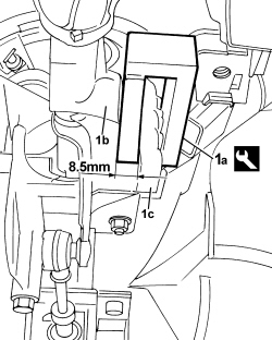

If it's not stiff, and the oil does not improve it, there is a left right adjustment, but it's rare it need adjustment

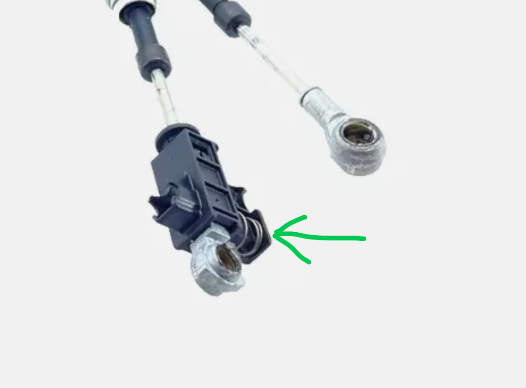

By far the most common is this
