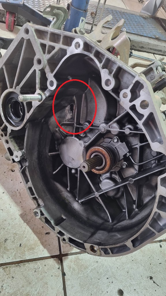

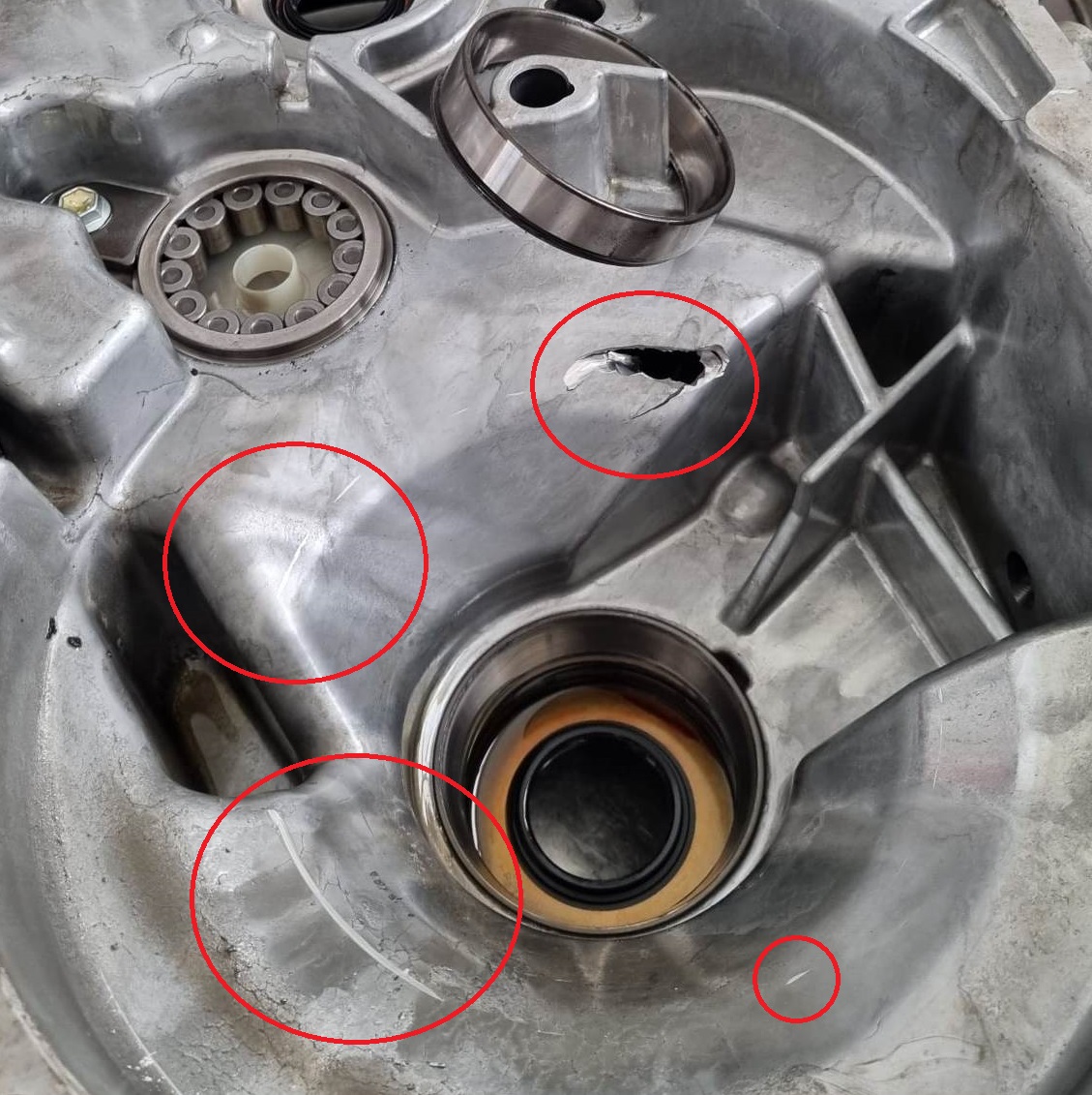

I had an unexpected transmission oil leakage last week and when i visited my mechanics they found out that i had a hole on the geabox. No noise or malfunction while driving. The first guess is that there is a bearing failure on the transmission axle, the gearbox has not been opened yet so i dont know what is the root of the failure. Any similar issue from anyone ?

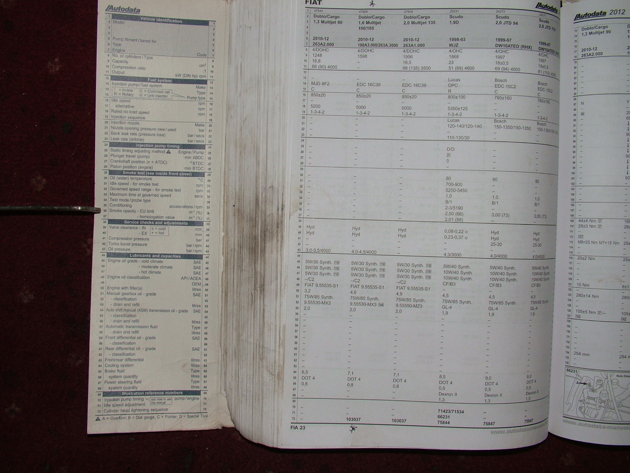

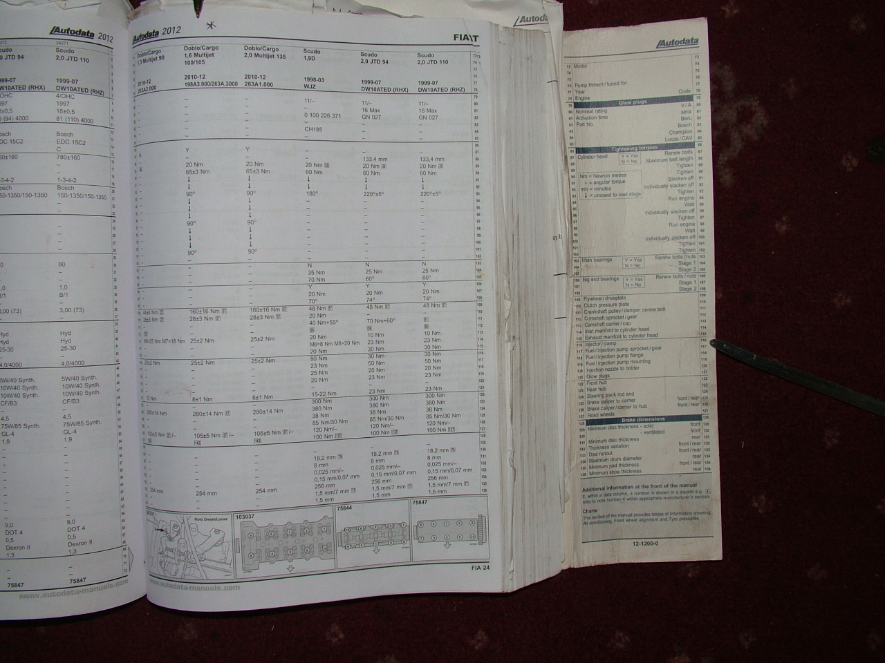

I have a 2010 Fiat Doblo Maxi van, it sounds vaguely similar, 6 speed manual gearbox 1.6 multijet diesel FWD only.
Any of this look familiar?

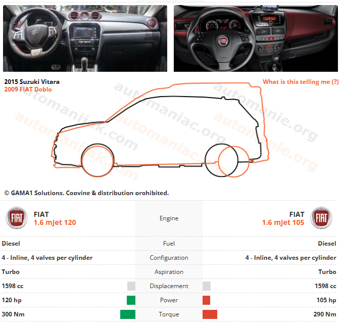

Thank you for the information, from what I can see on the table above, if your car has 105 HP then i think 1.6 multijet is what i have. I am not 100% sure if these engines are equipped with the same transmission system and 6 speed manual gear box for 2WD .

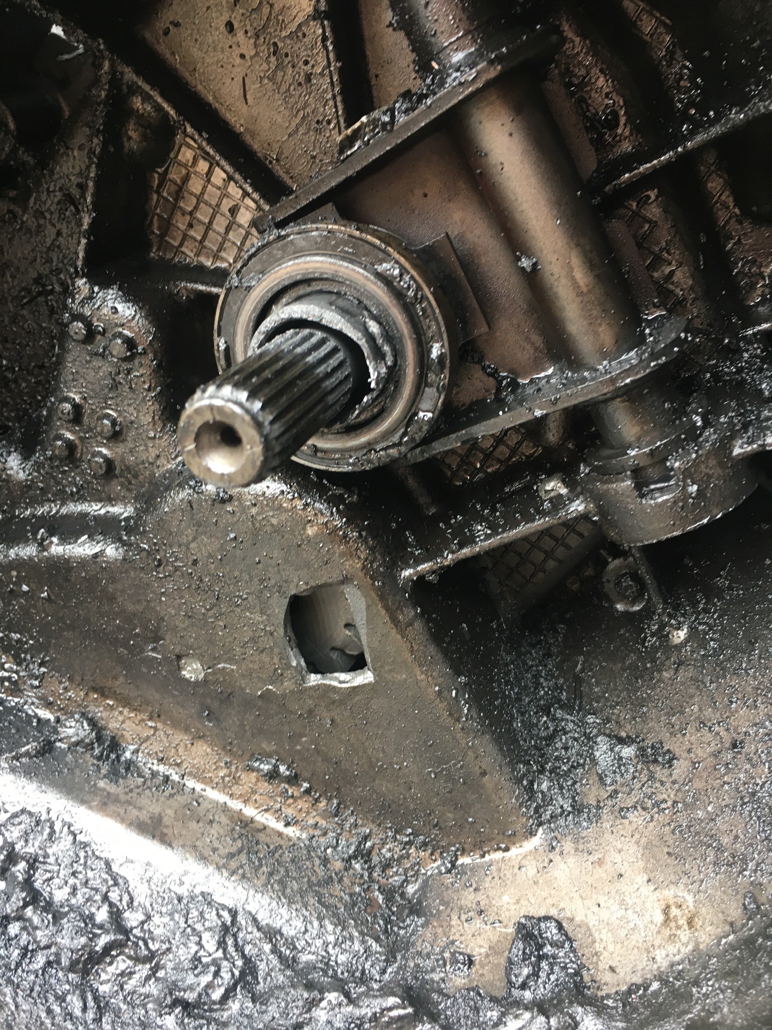

Looks like a bearing failure here mine where a ball bearing escaped and made its way through the bell housing

That gearbox was scrap damage to the differential gears, case and input bearing
If you can wiggle the input shaft from side, it probably not a good sign, but at the end of the day you can only assess the gearbox by stripping it down
The diesel is a Fiat 1.6 DDiS
Couldn’t find any info on the ZNB gearbox at all
My Fiat Doblo 1.6 is the 105 hp, it is all in situ with covers etc. on so not easy to check if gearbox similar for sure. I suppose if you have gearbox specialist who can get all the parts and have the casing alloy welded? But it sounds like it may be a lot easier if the the Fiat 1.6 multijet 6 speed gearbox was available and the same!
If Suuzki put a Fiat engine in their vehicles it would make sense to use the same gearbox from a cost of production point if nothing else.

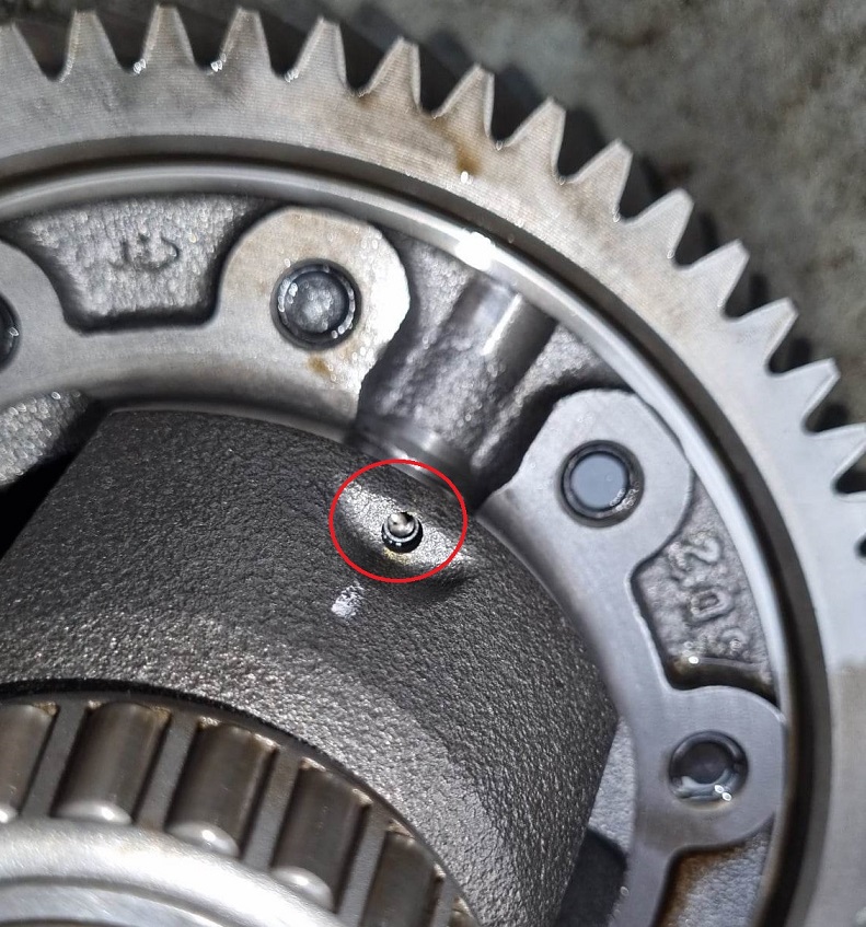

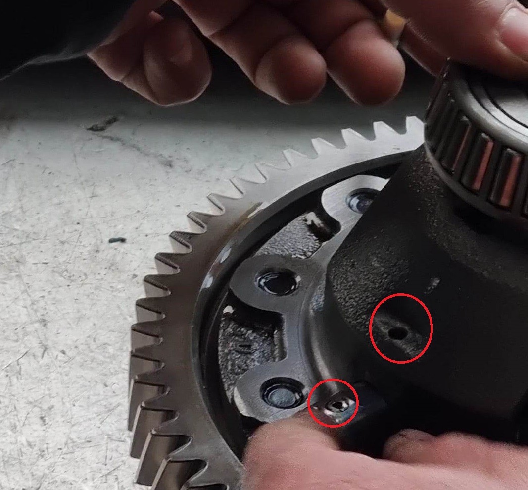

Finally, the reason was the pin on the rod of the transmission bearings .
We are thinking of replacing the pin and the rod. But i am a bit skeptical about the tolerances, they might have been affected
and also the cone bearings...
