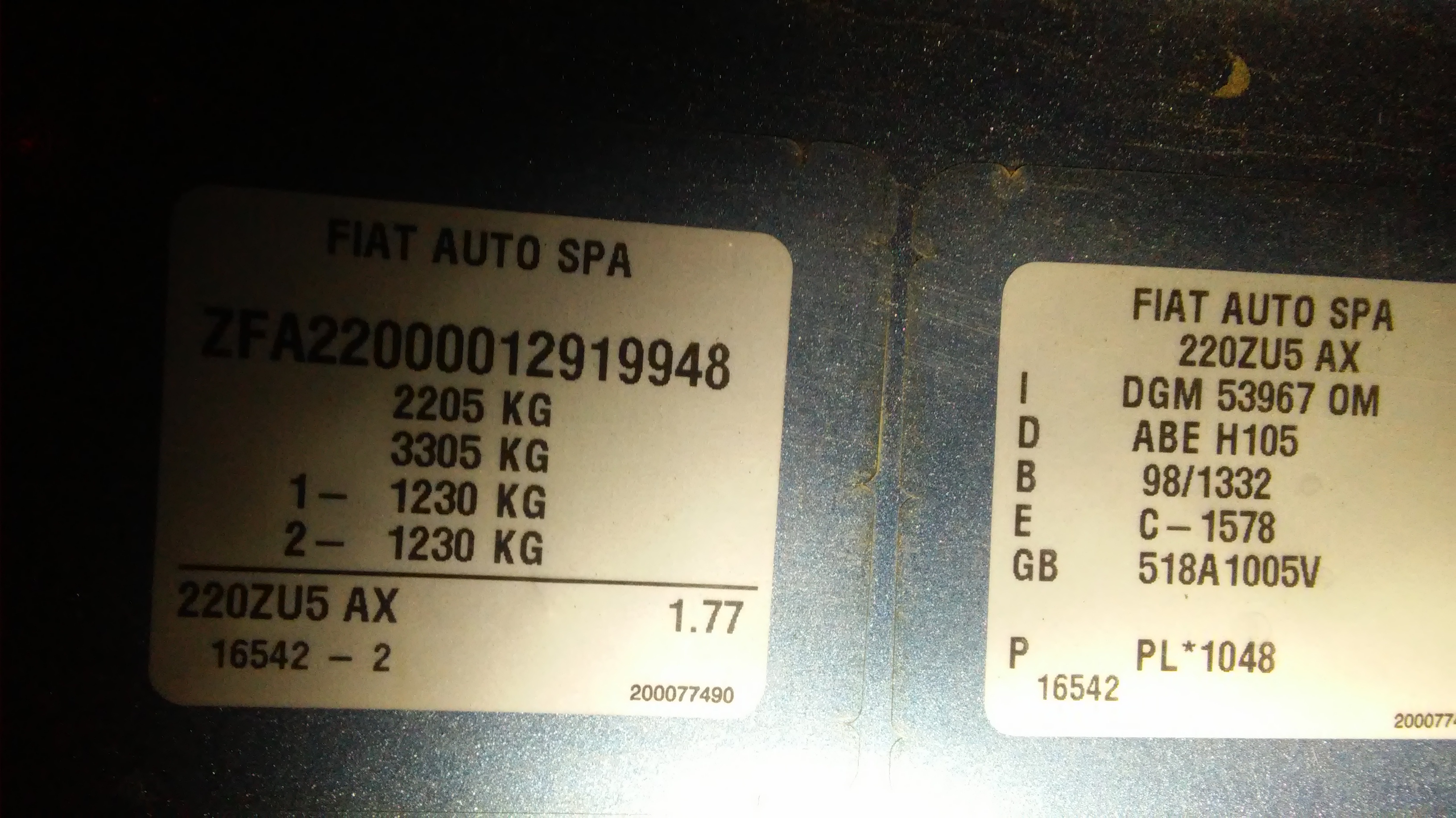

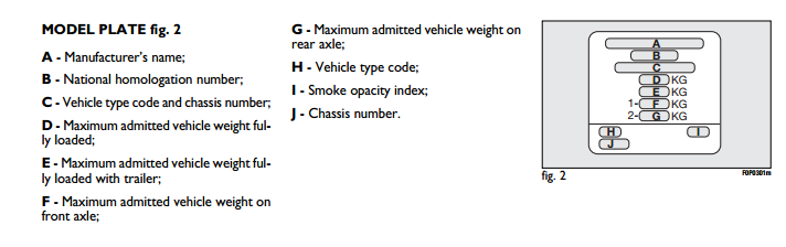

Look at the plate on your vehicle and this will explain what's what on it, D,E,F & G are what your interested in:
If your still not sure, take the vehicle down to your local Fiat Dealership and ask them to explain what the plate means etc and your towing weight. Shouldn't cost you a penny.

Thank you. So "E" minus "D" is the towing capacity? Does "F" and "G" have any influence?
If just the first bit, then that makes it 1100kg in case anyone else comes on here with the same question another time. :)
I think F & G only really come into play if you have the Scudo fully loaded also (don't quote me on that as I don't do towing).
Best bet is buy the owners manual linked on eBay which will break everything down for you and save some headaches in the future if needed. The owners manual will have something like the below in it which explains everything:
