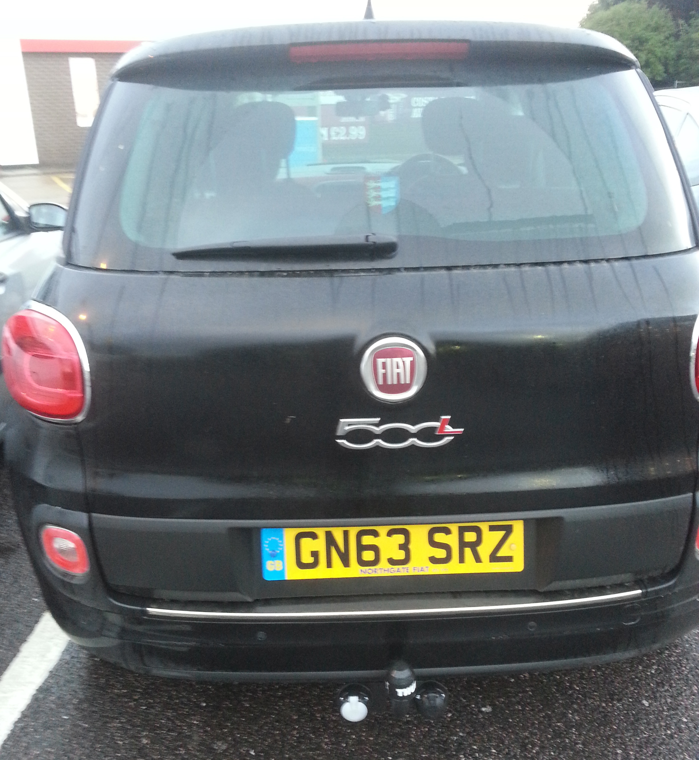

Got my towbar fitted. (y) Thule swan neck with twin electric. Very pleased with the result.:)

Hi,
Did you go for fixed swan neck?
Is it Ok with the parking sensors?
Did you go for bypass wiring or vehicle specific harness?
Why twin electrics, guess you won't tow a caravan with the twin air and single fine for a trailer?
Just got a quote £329 for a thule fixed swan, single electric, with vehicle specific harness, fully fitted Inc. Vat and lifetime warranty, is that a good price?
Lots of ? :)
Oh.. And.. Can you measure the centre of the ball to the rear bumper for me? Looking at a cycle carrier that needs 65mm. Fitter saying that they don't have that info so won't know for sure until fitted.

Hi, yes I went for the fixed swan neck. It's no problem with the parking sensors, thank goodness, although if the tow ball cover goes askew it occaisionaly triggers the sensors. I had the twin electrics fitted because I have a leisure battery and fridge in the folding camper.
The twin electrics have changed a bit since I fitted them myself on my Mulitpla many years ago. I'm sure I used to have two relay controlled Live feeds on the grey plug, one for the fridge and one for the leisure battery. With this set up I have now, I only have one. At this time I'm not plugging the grey plug in and to be honest I probably wouldn;t bother with them again. You can't really get any noticeable charge in to a leisure battery or cool a fridge on 12v to any degree unless you are driving for several hours. By that I mean more than 4/5 hours consistently.
I had the 13pin on the 2nd Multipla but it was a bugger for fault finding, if I'm honest. Two seperate plugs is much easier to test if you're towing older trailers like I am. Any fault is ALMOST certain to be in the trailer electrics on my old stuff, but I did find one fault in the 13 pin connection and it was very confusing for a little while. I'll stick to the old grey and black plugs (12n/12s I think?):)

The place where I am going to have mine done says they have done a few 500Ls with a Witter flange towbar with single electrics and they have had no problems with the parking sensors but the only guaranteed method is a detachable towbar (this is £345 vs £225 for the flange) due to the possible variation of the vision of even OEM parking sensors. They said they have seen on other cars even the towball cover making the difference.
Despite their reassurance I'm still worried about it as it's a bit of a cockup if the car constantly beeps every time I engage reverse.
Looking at your twin electric one though I'm hoping it will be Ok as a single electric flange isn't going to be any bigger than your twin electric swan...
Hmmm, take the risk or pay the extra £100?
Or.. I could go with the fixed swan neck which they've said is only £15 more than the fixed flange at £240... Sounds like a plan.

Any chance you could let me know what the gap between the towball and bumper is with yours?
Thanks.
Here you go, reporting from my camping holiday in the New Forest. When looking down from above, the centre of the tow ball is 7cm from the bumper.
That is the exact centre of the ball, not the edge of the ball nearest the bumper. The edge of the ball nearest the bumper is 5cm from the bumper.:)
Hope this helps. Panda.
Yea that's really helpful. Thanks.
I will be getting mine done with a fixed swan neck (single electrics) when I get back from holiday.
Bike rack I was looking at needs 65mm clearance from centre of ball to bumper, so if I get the Thule swan neck that should be Ok.
However 5mm clearance means the car is inevitably going to get bumped/scratched when putting the rack on and off so I'll probably buy the more expensive Altera rack which sits on the ball like an egg cup on top and doesn't protrude more than 1cm toward the car (looking at the video it looks like that anyway).
