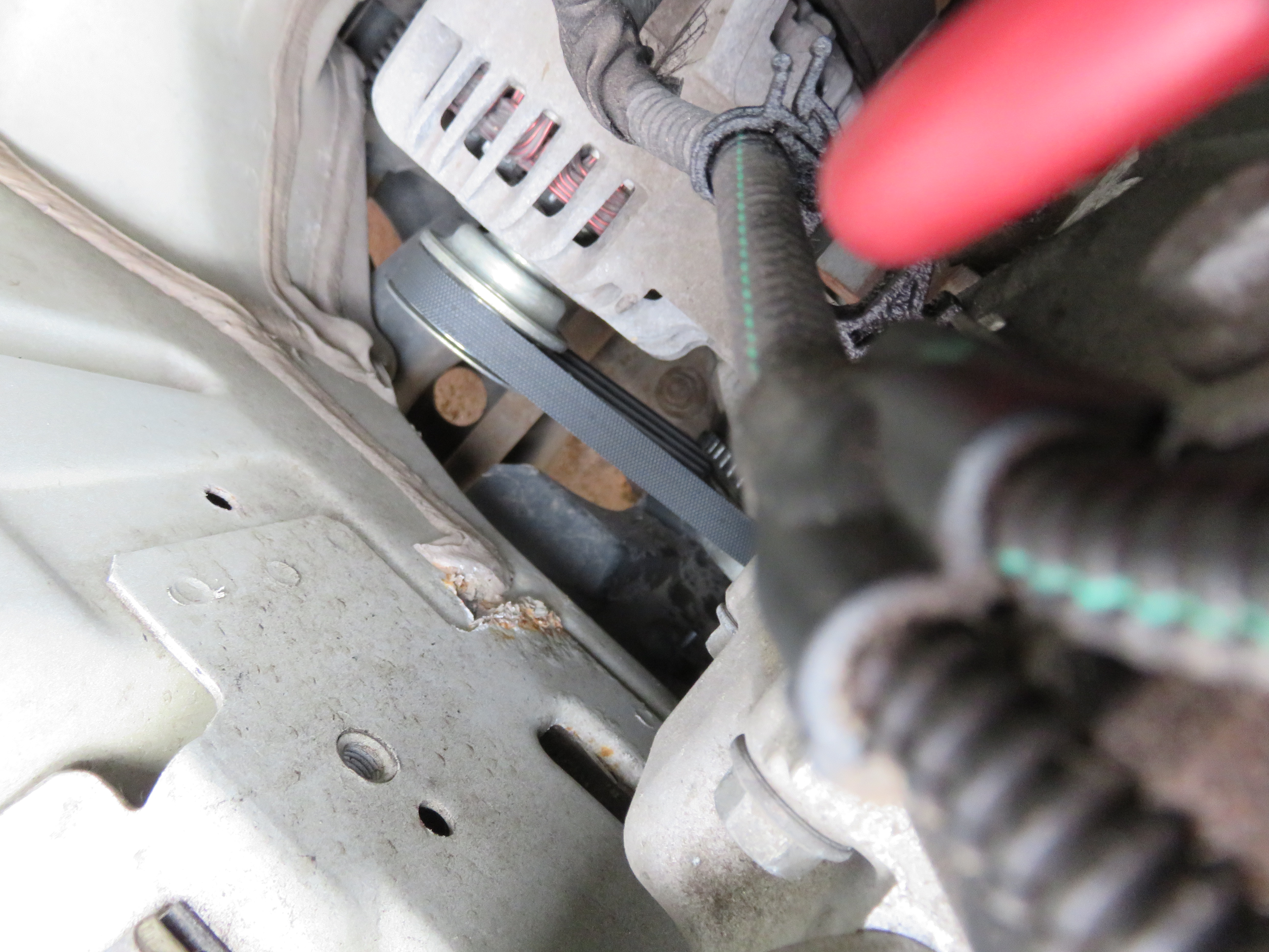

General touch of the rust
From that description knowing panda 2012 onwards I would suspect its had an impact at some point.
Is the front of that area body coloured.
Tkm
Hmm :confused: Some of that looks like more than just surface rust and it would need some contact with water to get that bad.
I would have a poke around with a small screwdriver, remove any loose rust and look for corrosion penetration of the metal. Also remove the drivers side wheel and plastic splash guard and look for any rust there.
Then get it treated with rust curing products.
It's a bit of a mystery. No sign of corrosion there on my six year old Panda.
It looks mire like the bracket mounted/welded on top rather than the chassis leg. Would still need some attention.
1.2 non aircon petrol. ?

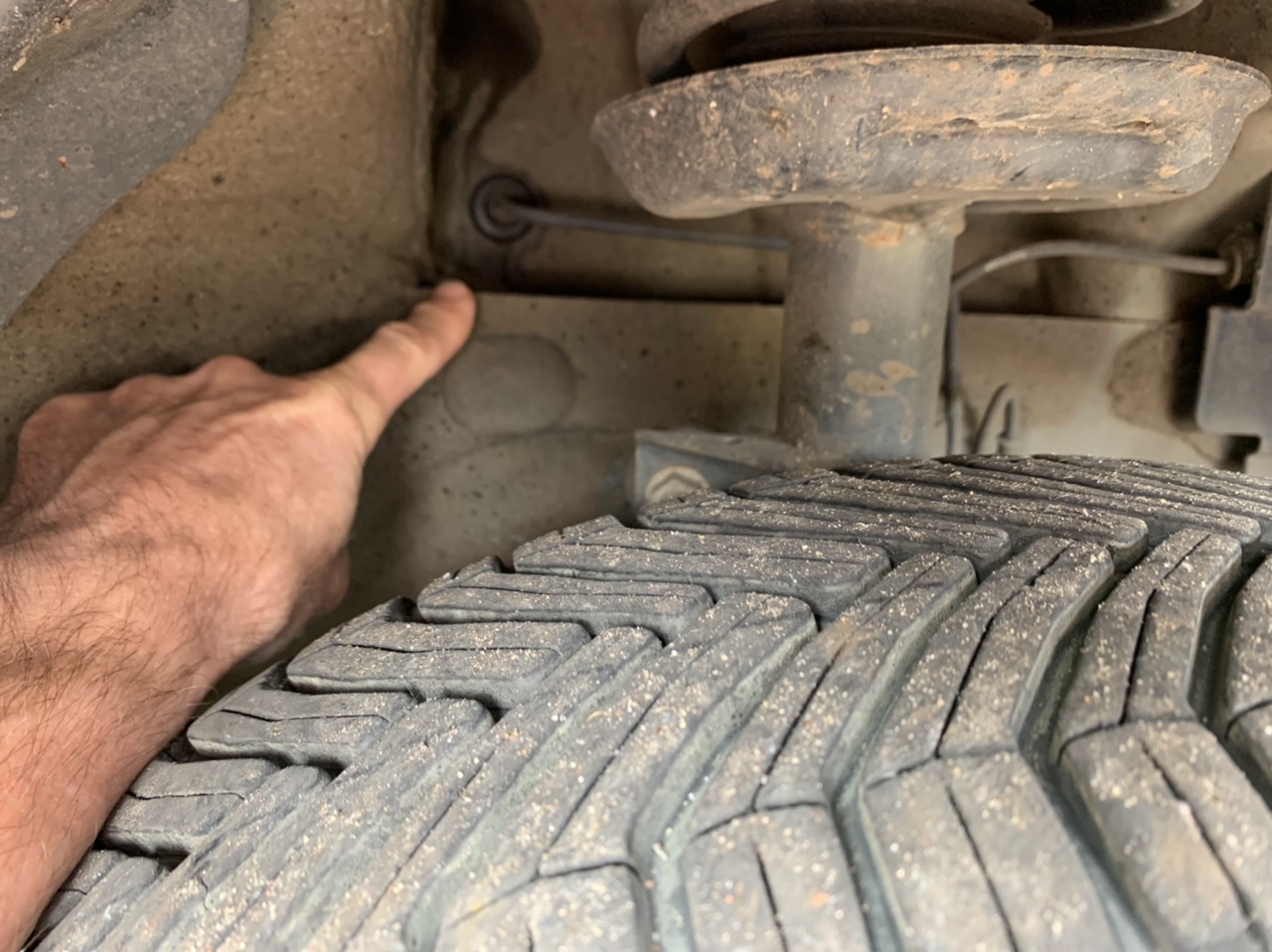

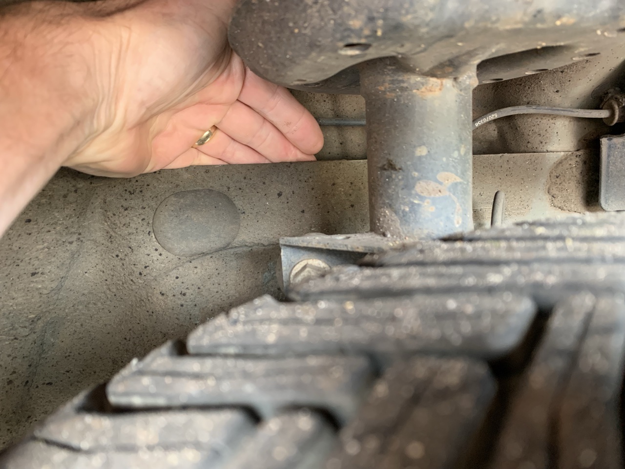

I've commented before about the value of regularly hosing out under the car, especially in the winter. The slight rusting you are seeing starts because mud collects in a 'well' under the wheelarch, behind the suspension spring as you look across from the wheel towards the engine. This holds dampness (and salt) against the bodywork in that area, which the metal part in your photos photo is the inner side of.. Regularly washing this out (just with a regular hose nozzle, not a pressure washer) clears this away. While there, also wash mud out from the spring 'cup' at the base of the spring.
Easy to remove the liner?

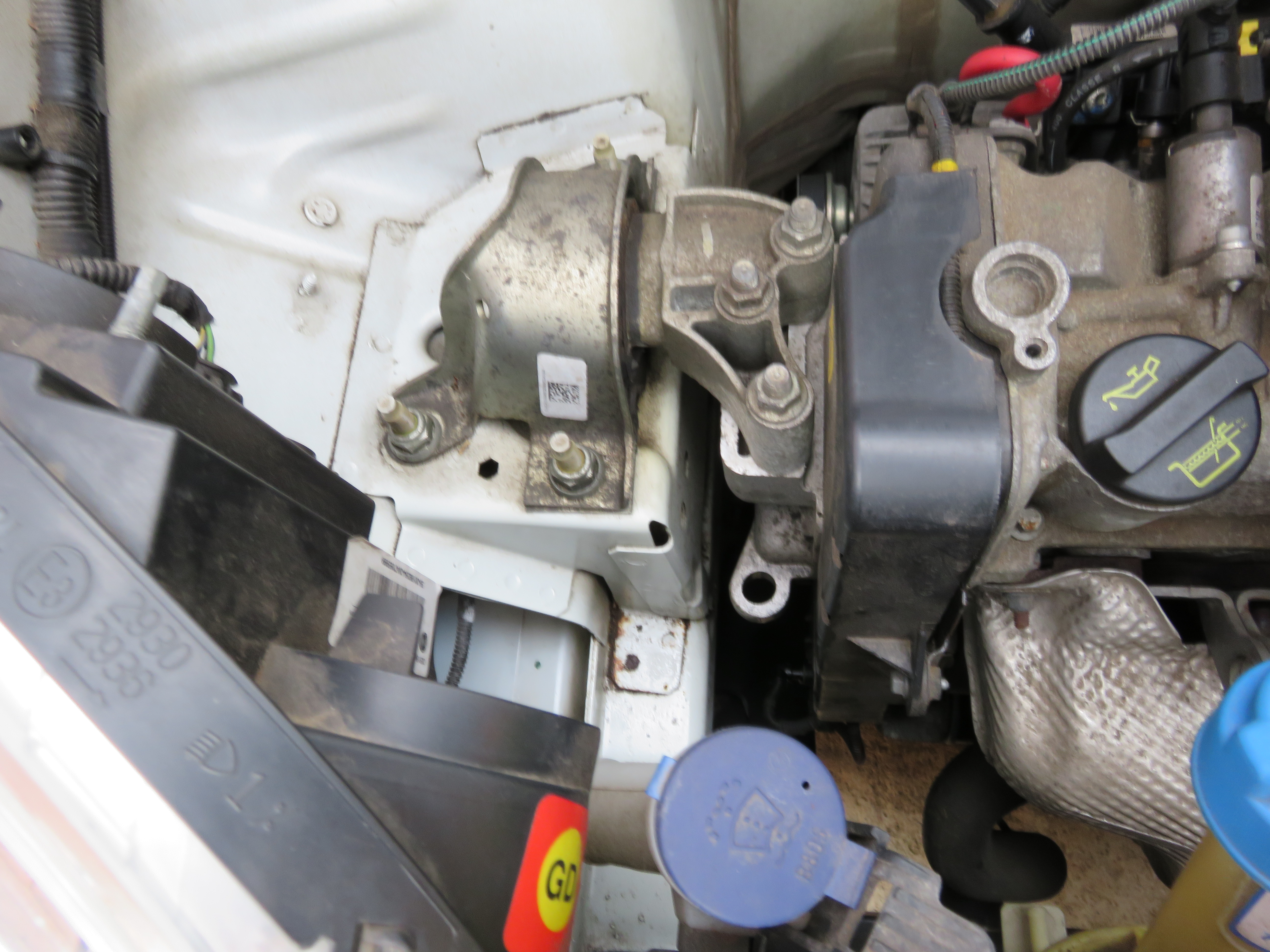

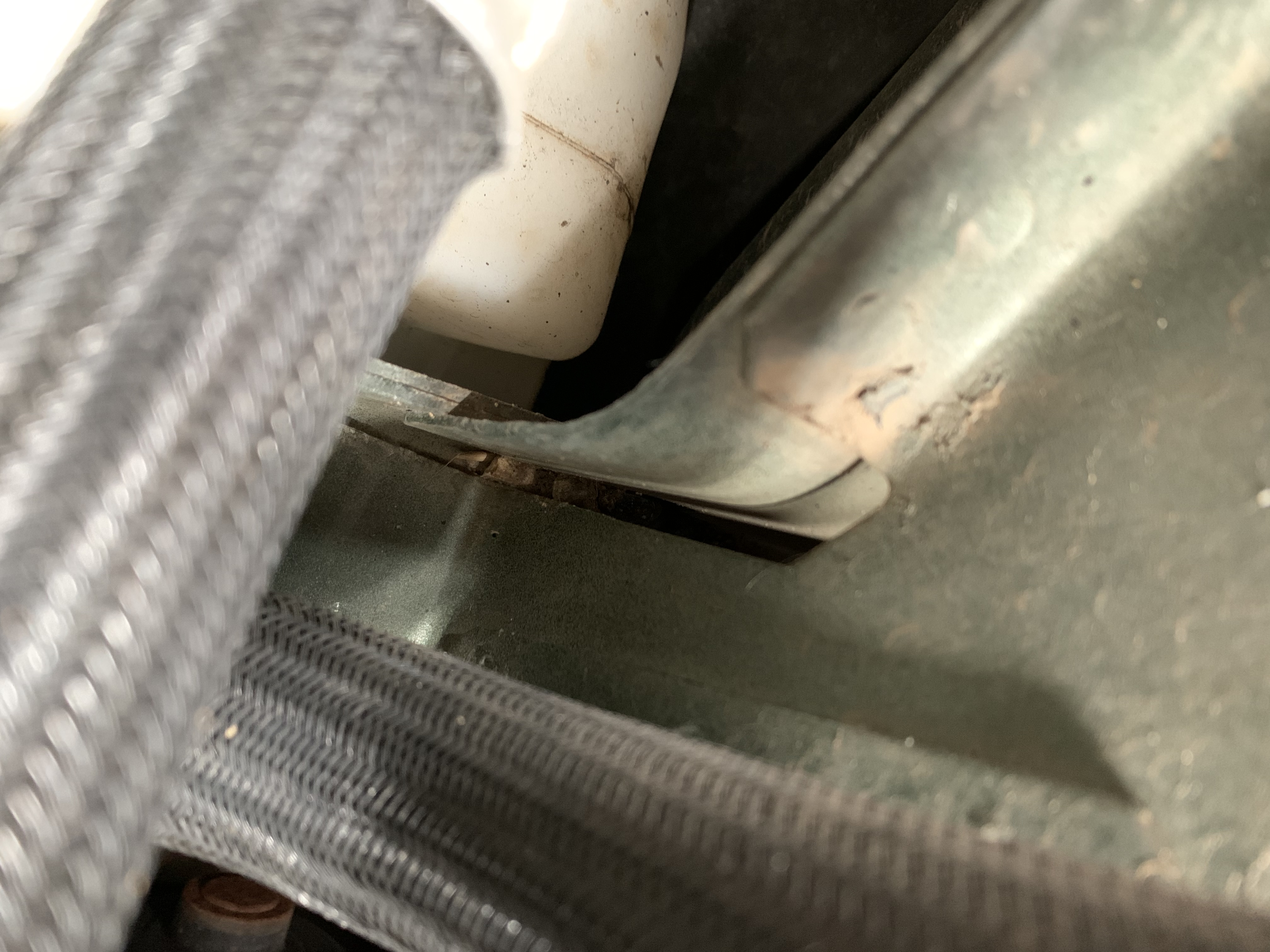

Leroypanda Here’s a couple of photos looking into the wheel arch, directly across towards the engine. In the first one, I’m pointing at the area where mud collects. In the second, you can judge the depth of that ‘shelf’ in the metalwork by the way my little finger is hidden. The third photo shows a similar under-bonnet view to one of your pictures (but with added pipework in the way). You might just make out a little gap? That gap goes through to the wheel arch and there’s some mud there as I was driving across a field yesterday. It’s about to be hosed out today. (The last photo is sideways - but turns round if you click to view full size)
Yep its going rusty there to! (2nd pic where your hand is)
