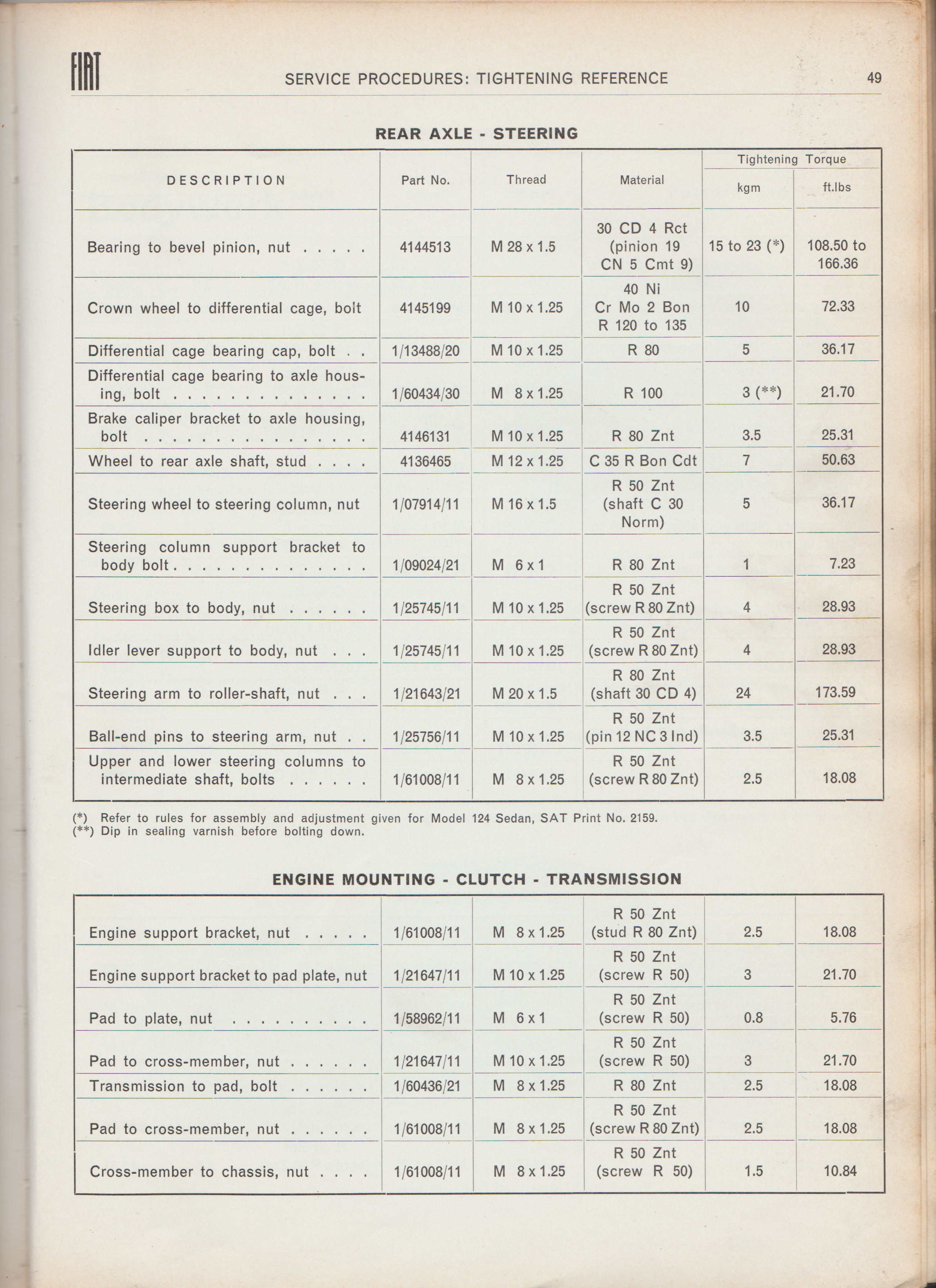

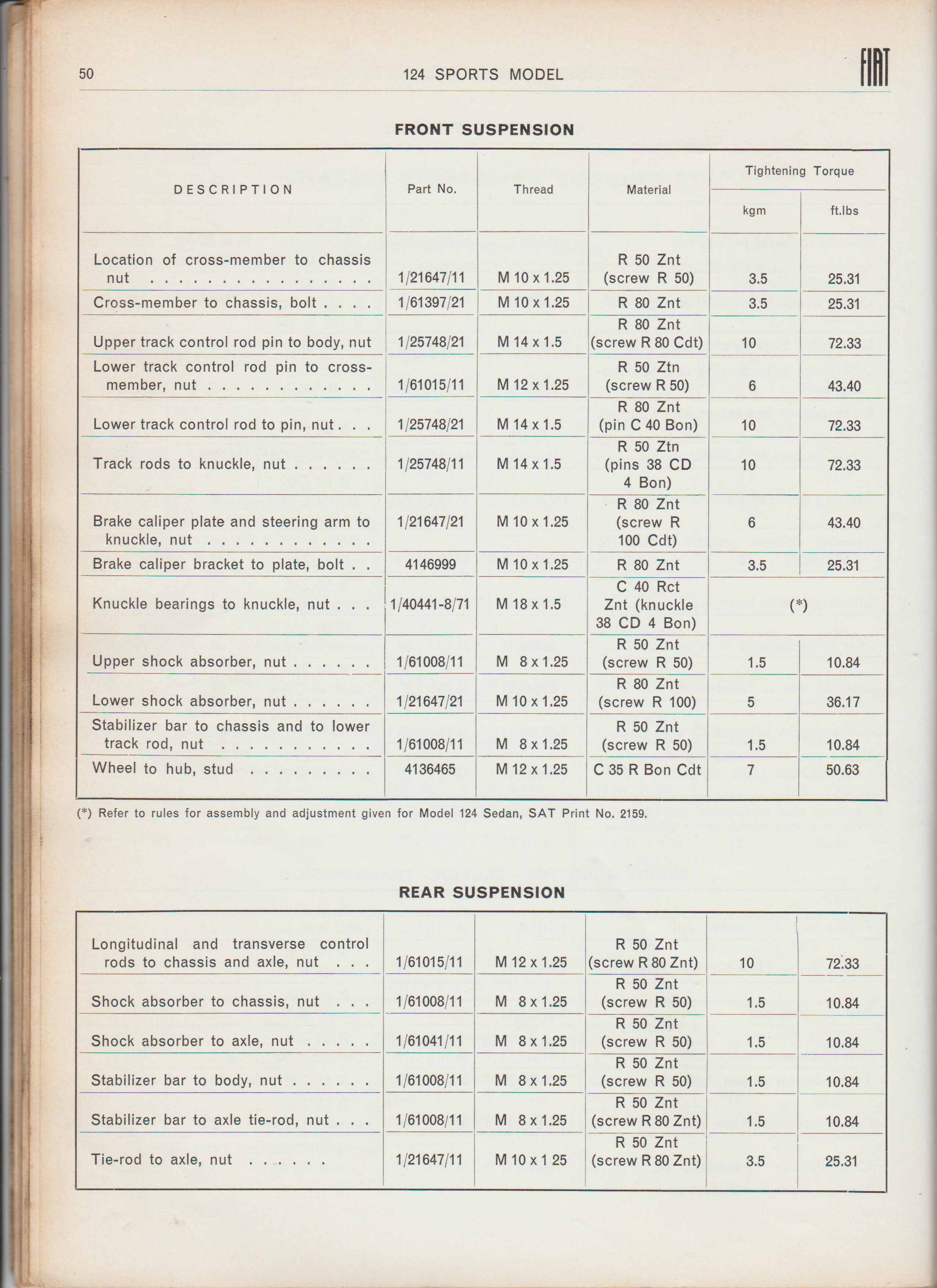

Here are the figures from an official Fiat 124 AC servicing instructions guide from 1969 :-
So, doing a little interpretation of Fiat parts terminology (just in case you're confused), the settings you've asked for would seem to be :-
ball joints - M14 x 1.5mm thread = 10 kgm (72.33 ft.lbs)
track rod ends - M10 x 1.25mm thread = 3.5 kgm (25.31 ft.lbs)
Hth (y)
