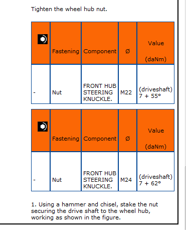

Fiat eLearn has this for all drive shafts from 1.2 to 1.9: 7 daNm is 70Nm plus the angle

Thanks for clearing that up Andy. One poster on this thread has 36mm socket size. I was reading a punto sports UK thread saying it needed 280nm.
True enough, I was remembering my old Escort which I proper screwed up by over torquing - it had separate bearing shells and tapered bearings.
It would be interesting to see what 70Nm plus 62 degrees finalises at as the the torque mounts up fast once a bolts becomes snug. Maybe the 180Nm/240Nm is a simplified go to figure Autodoc and Haynes etc. have published for the average home mechanic?
IMHO if fiatpunt0 has done it up to 178Nm it won't be coming undone on its own accord. Stake the nut, mark it with paint and check again in a few weeks. Then forget about it.
Angular torque figures are normally used when you are stretching the components, like headbolts and the torque value is a bit different on every bolt.
And at high torque then you have the condition of the thread to think about, a rough thread will need more torque than a smooth or lubricated thread for the same clamping force, so the angle is a better way since the clamping force is more accurate as distance along the thread rather than rotational force.
