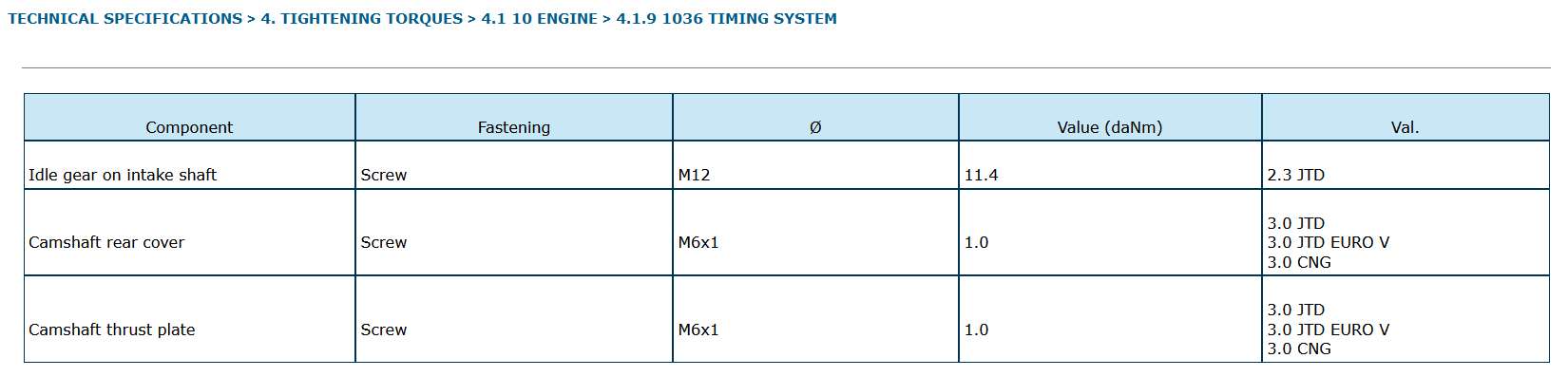

M moff New member Joined Mar 3, 2024 Messages 2 Points 1 Location LS22 6YW Mar 11, 2024 #1 hi! sorry but not good with p/c .i am trying to find torque setting for crankshaft timing belt cam bolt in 2.3 2013 multijet 130.thanks
the green vanper Prominent member Uploaded 10+ resources/downloads Joined Feb 7, 2023 Messages 2,354 Points 777 Location Silesia Mar 11, 2024 #2 Hello, Those are values I've found so far: Strange eLearn is showing values for other engines when I choose the 2.3 diesel... Is the bolt you're looking for on the list? Hope so...
OP OP M moff New member Joined Mar 3, 2024 Messages 2 Points 1 Location LS22 6YW Mar 12, 2024 #3 moff said: hi! sorry but not good with p/c .i am trying to find torque setting for crankshaft timing belt cam bolt in 2.3 2013 multijet 130.thanks Click to expand... thanks green vanper!. i have found the torque setting. its 300nm which is 221 foot pounds in old money the four smaller to this bolts that hold pulley wheel to this cam is 30 nm. cheers Moff
