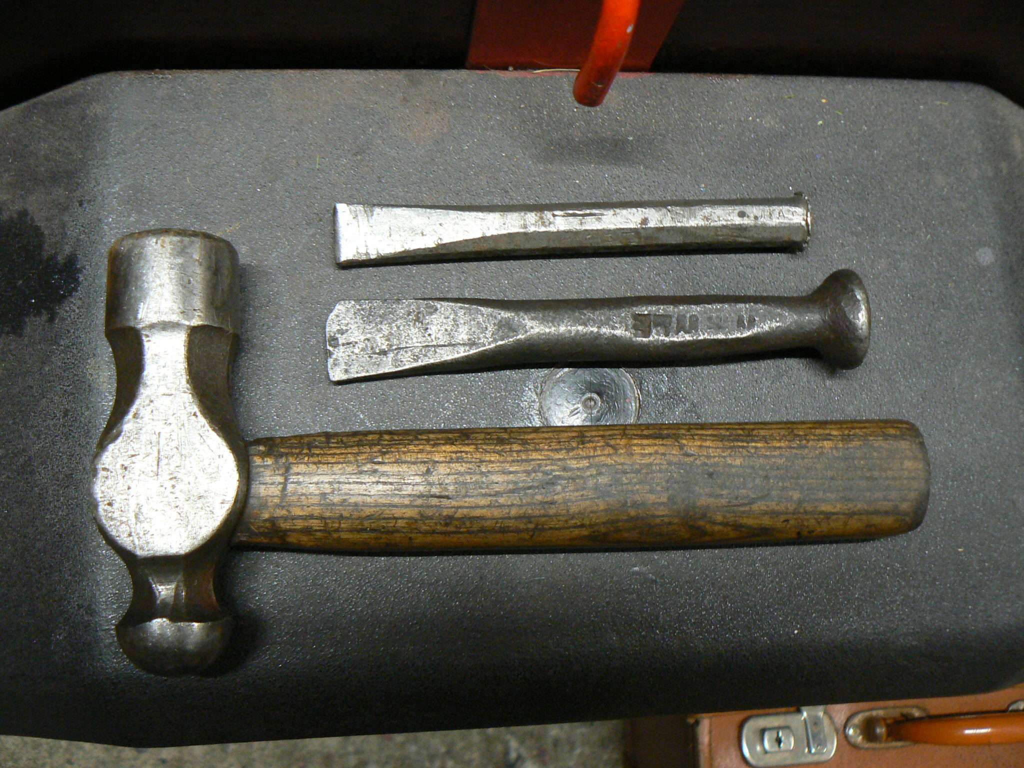

Can anyone point me towards the best tool for properly and safely staking a Panda's front hub nut?
Small cold chisel or scrap screwdriver
Would be my choice too. Here's the two I tend to use depending on how wide I need it to be.
I've put them alongside my short handled 1lb pall pein to give an idea of size.
And here's the ends again for comparison
How do you like the "fancy" chisel? the one second down in the first picture. I think it's one of the best looking chisels I've ever seen - just love the shape of it! Oh, and no, the end you hit is meant to be that shape it's not just that I've never cleaned it up.
I do have a 6" cold chisel and I think I'll have a go at modifying that using a grinding disc so the sharp end has a more suitable profile. My earlier staking efforts are not unsafe, but I'd like to do the job properly
