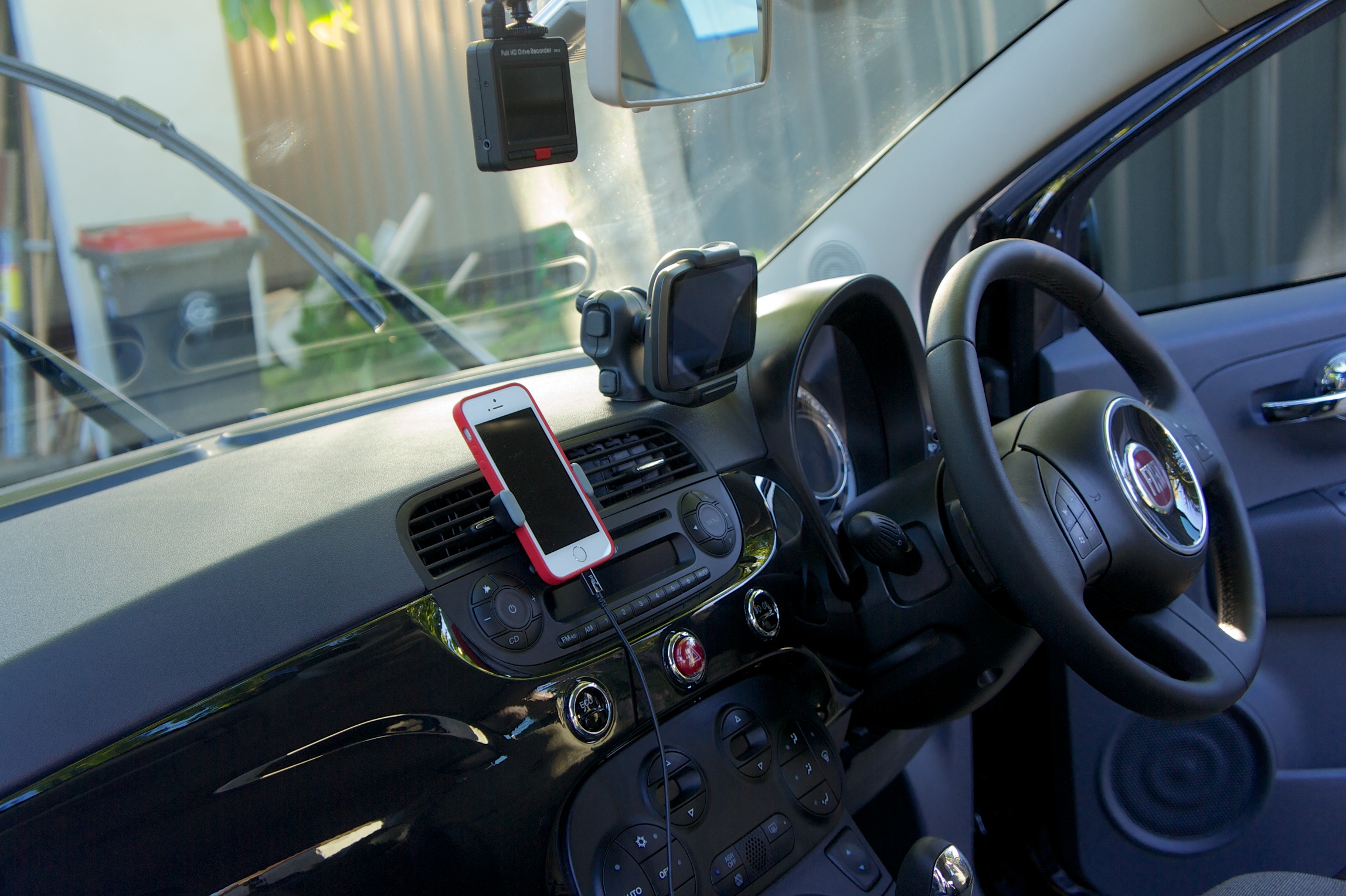

Question, how much gap is there with the 5000 in the cradle and the curved dash to the right. I am wondering if the 6000 will sit in the cradle and not touch the right side. thx.
There is plenty of clearance between the cradle and the dash as the following picture posted earlier demonstrates:

There's a better picture in my post which illustrates the amount of space next to the cradle:
https://www.fiatforum.com/500/328022-new-satnav-options-blue-me-dash-socket.html?p=3341173
