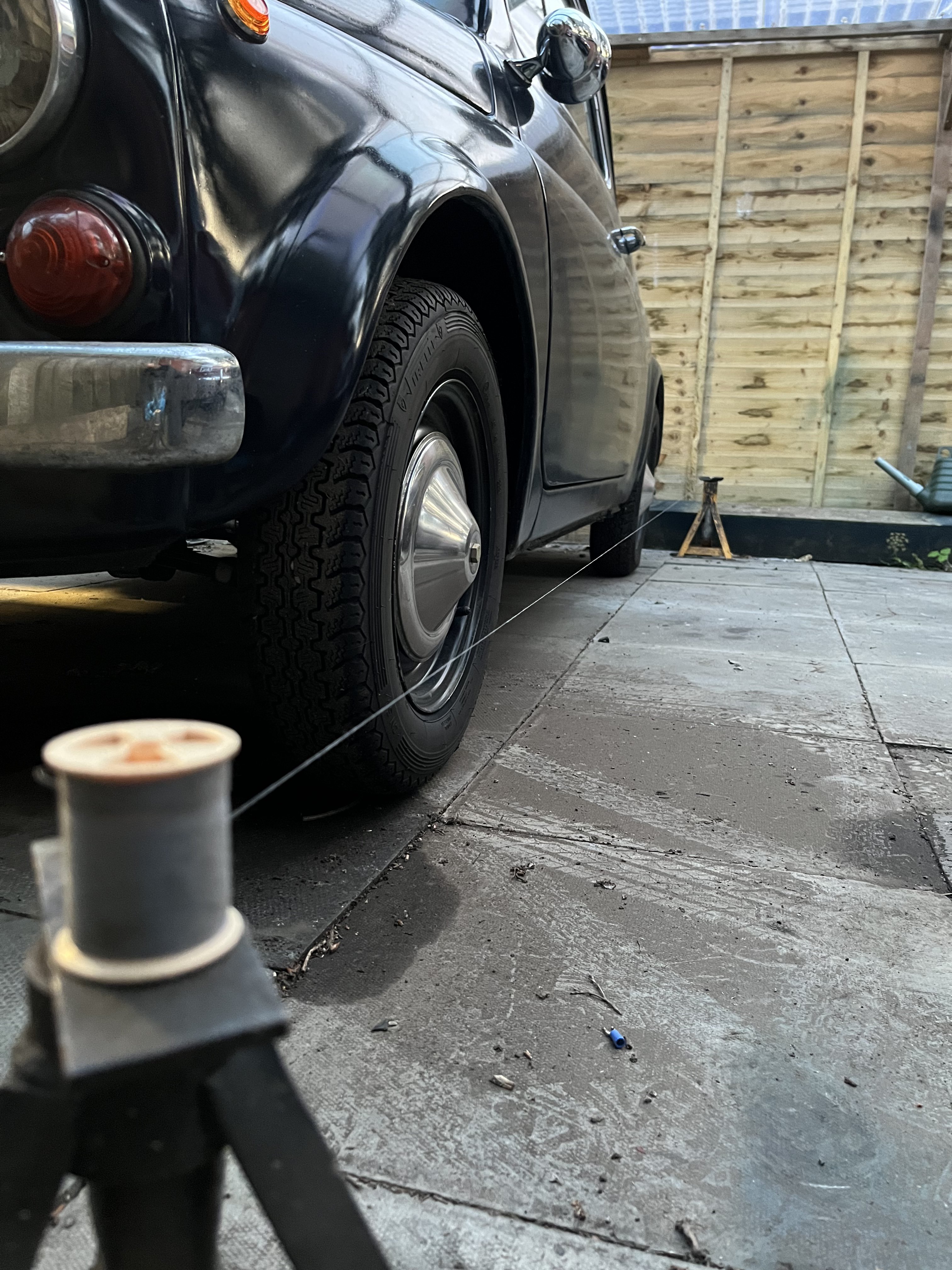

Is there a guide or some tips you recommend for setting up the toe; are you using a rope or tape measure?
You can do it with some string (I actually find a strong cotton thread easier for accuracy) and 4 axle stands or other sturdy but moveable objects. It’s a bit of a faff but it works.
You need to make a string line down each side of the car that is parallele, both to the car and each other, and extends past the length of the car. The line should be level with the centre of the wheel.
I start by settling up two lines and moving the stands till each line is 100mm from the centre of the wheel (the wheel trim bolt makes a nice datum here). Then I compare the distance between the two string lines in front and behind the car. If the lines are parallel then this will be equal.
In my case the front ends were ~15mm closer to each other. Then there is a bit of trial and error to change the stand position till the lines are parallel to each other and the car. I ended up with the lines set at 106mm from each front wheel and 100mm from each back wheel.
Now that is done, if i ever have to repeat this process, I now I can go straight to 106/100 and be really close.
Ok so that’s the annoying, time consuming set-up done. The next bit is easy…
Simply measure the distance from the string to the front edge if the wheel and compare that to the distance from string to rear edge of wheel. You are measuring to the wheel rim edge, not the tyre.
If the distance is greater at the front edge you have toe in, if the distance if greater at the rear edge you have toe out. For each axle you need to measure both sides of the car and add them together.
So when the book says 0-2mm toe in, you would want to measure 0-1mm on each wheel.
It’s a slow and awkward process, but with care it works and doesn’t require and special tools.
