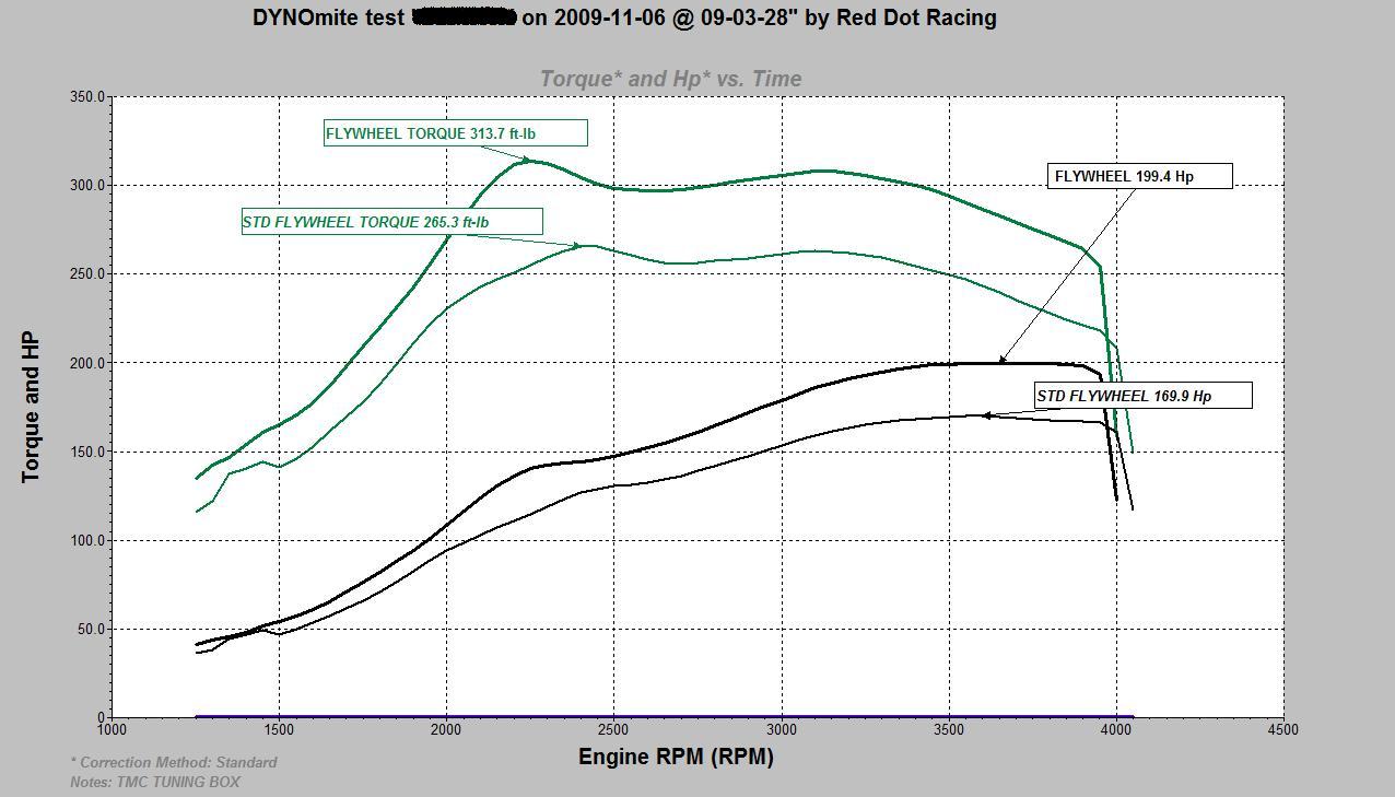

2008 Bravo 1.9 M-Jet 150T - 2 runs; 1 * standard and 1 * TMC box fitted

there decent results how much did that cost you to get the test done?
looking at your chart as well it seems with the TMC tuning box on its smoothed out the power delivery at the start or am i being simple and not reading it correctly?
Graig, the TMC box plugs in between the common rail and ECU loom and as such I assume is an amplifier circuit only (TMC Daron -any more info here?). To smooth out the dips you would need a full remap. However this is more expensive on two accounts purchase and dyno time to set-up.
As more power comes in earlier the pick-up from low down is much improved which is what I wanted to fix. The kit was £115.00 Inc of VAT & delivery and the dyno cost was £50 for two runs. Having been out this morning for a blast round the local roads it feels like a different animal and as show in the chart has loads more power all over the rev range. A very good result for a small outlay (y)

I'll try and explain how the box works, on diesel engines unlike petrols getting more power is very simple, with a diesel engine basically adding more fuel (within reason) creates more power. On most diesels even when re-mapping you can achieve results only by altering fuelling at least on cars pre-cat (DPF) although most good re-maps will have many alterations to achieve the best results.

I can tell you its unlikely you will get a better graph than this even with a re-map! We also do re-mapping so I speak from experience.

lol i was saying lookin at the graph that was posted it has smoothed out your power delivery from the lower revs if you look the power doesnt go up then level out then go back down like it does on the STD run. so looks like its smoothed it out just using the TMC tuning box..
