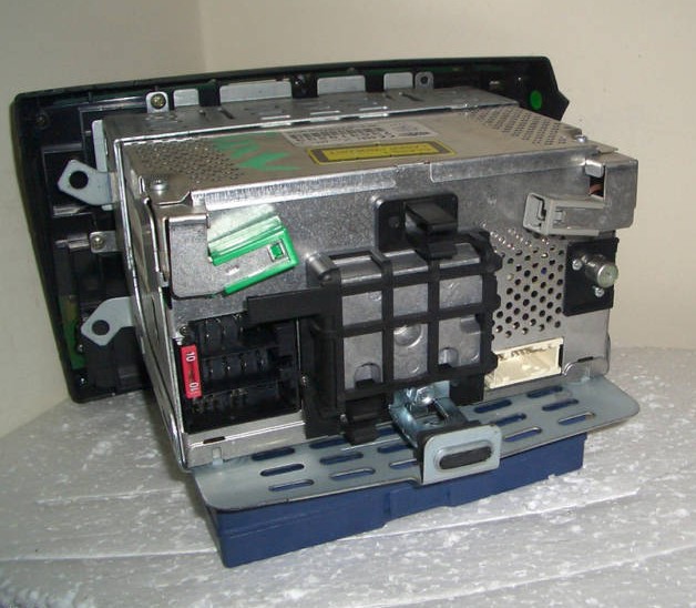

No... all the connectors just pull out from the rear of the CN+.
As I remember, the power supply and speaker connectors that go in the top 2 black sockets have locking clips that you squeeze together while pulling the connectors out.
The bottom black socket could have up to 3 different colour connectors that are clipped together. Each of them has a plastic locking clip that you hold while pulling the connector out.
The white CANBUS connector has a lever locking mechanism. The connector comes out as you lift the lever.
The GPS and GSM aerial sockets have small locking bumps that you may have to push in while pulling the connector out.
The radio aerial just pulls out.

no i meant getting the actual harness out of the car
You will need to remove the complete dashboard if you want to get the wiring loom out. But you only need to take the CN+ out to remove a stuck CD.
