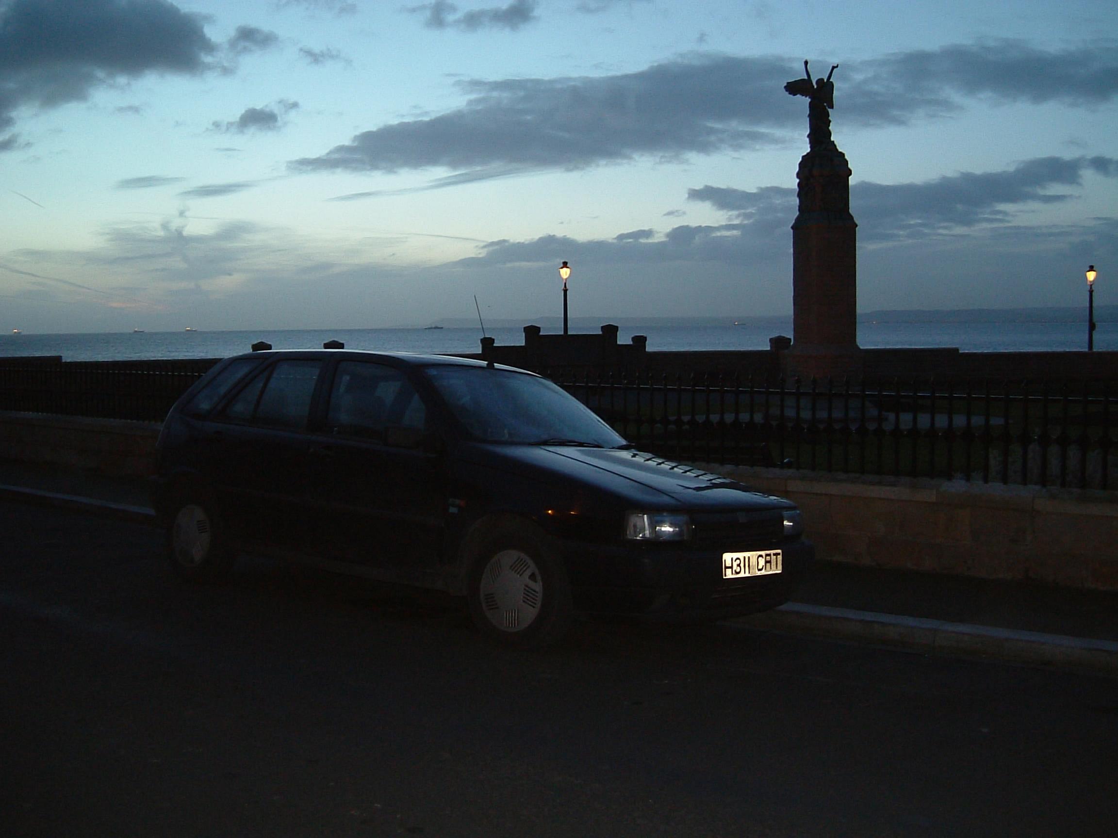

Suddenly had the need to post this pic..
Drove me 100 miles to Sheffield each weekend and the 100 miles back without so much as a stall for a fair part of a year. Only replaced in Aug 2005 due to the purchase of the Sedici, and the clutch being buggered after being replaced by Mr Clutch.
RIP 398sfm..

Awwwww!!!! I hate that!!!
Yes, Mr Clutch would be the last place on earth i would take to get a clutch done. I know of at least 2 people with problems. 1 took them to court, and the case got mentioned in the Manchester Evening News. Mr Clutch lost the case and it cost them over £20,000 in legal costs and bad publicity!!!!!
Andy.
Indeed. Horrible, horrible people.
A guy with a Ford Scorpio joined here just to add his support after his Ford had been made a write off practically by the bodge-ings of Mr Clutch. Seems one franchise is as bad as another.
