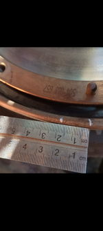

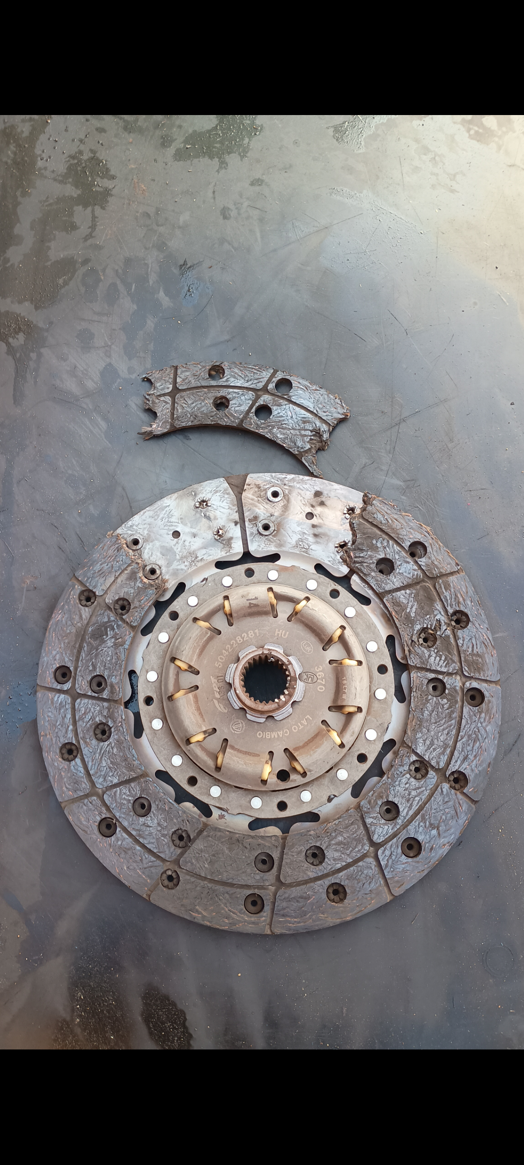

When removing your clutch could you please check your flywheel for movement by rocking it. Also measure the the free play & are there any heat spots. I also measure clutch thickness along with miles (km) it's done & check for cracks.
This is just for my interest as I keep track of them as this info could come in handy one day.
I have come across a clutch plate with cracks & also one broken. Both these have been on low km motorhomes but older in years so they have been sitting still for long periods.
I believe its best to use it. The most I have seen on a 3.0l manual is 610,000km (still going) used in Aus as an escort vehicle for oversized loads.
New clutch thickness 10.4mm
250,000km (156,000miles) 8.6mm thick - Flywheel freeplay 18mm
Broken plate 97,000miles 8.5mm thick - Flywheel freeplay 22mm
