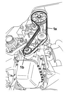

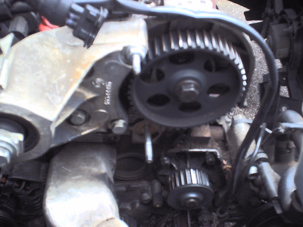

No idler on the 1.2, just straight over the cam, around the water pump, around the crank pulley sprocket up around the tensioner and that's it. Wise to change the water pump as they tend to start leaking at 60k miles. Haven't ever had a problem with non Fiat water pump

Here's the job on an identical 1.2 Bravo engine. Water pump is lower right in picture
