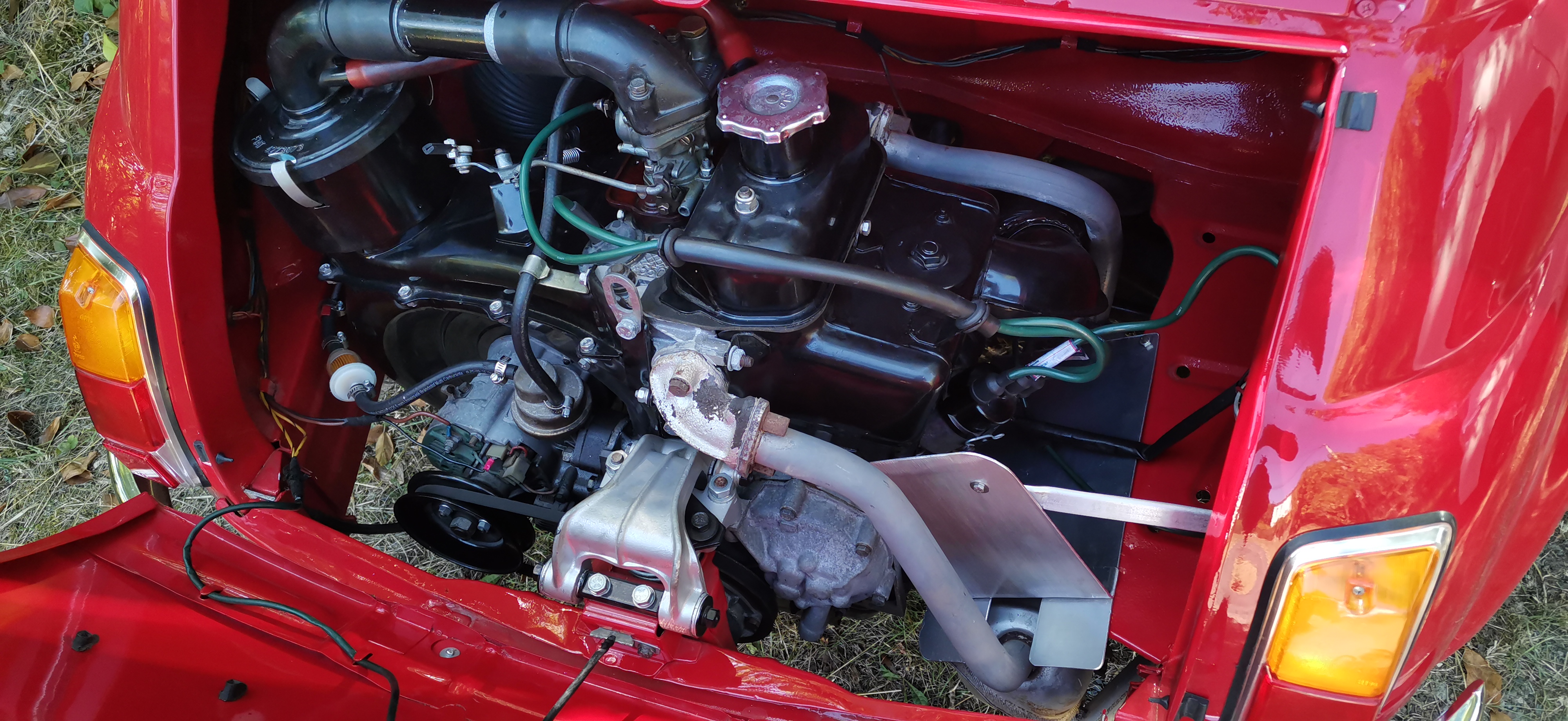

Just checked, my olio sender and circuit work as normal so à priori, no oil pressure issue. Here's a photo of the beast.
Neatly made, but very unusual, heat shield---have you tried running without that in case it is touching something when the engine is hot? Also, please remove that fuel filter--(a) not required (you have 3 in the system from factory ---pick-up in the tank, top of fuel pump and top of carb) and (b) it is plastic; if it should break it will spray fuel over the alternator--not a good thing.
Hi Hobbler, thanks for the advice re the fuel filter. I'll take care of that. I left my car parked at my wife's uncle's place saying I would buy the missing heat shield and fit it. I came back two days later and he'd made and installed that. It is a good fit/firmly attached and engine bay is noticeably cooler with it but unfortunately the mystery noise was there before this was installed.
