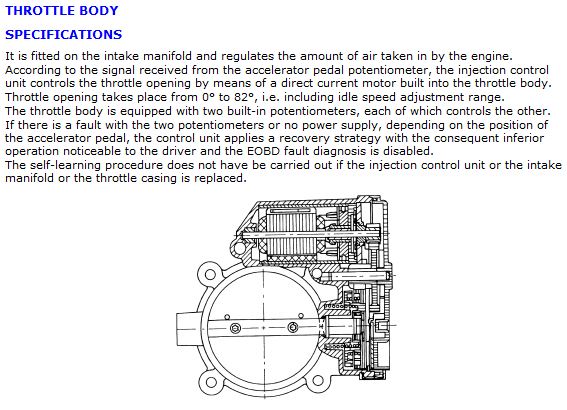

Hi Don (I guess),
the reasonning seems correct in the big lines: the throttle assy is not so much complicated: one motor and two potis; all of them managed by the ECU ...
Here above you'll find some description that might help you decide where to look . It's from a 1.4 16v but I'm pretty sure it's very similar.
BRs, Bernie

Thank you Bernie,i am fairly sure that it will require a new throttle assy.
I spoke to my garage today but he understandably does not want commit to replacing the assembly if it should turn out not to be!and because of the potential cost ,personally if its going to cost a couple of hundred it would be worth it from a driving comfort point of view,so i might start looking and saving! then it is where to scource one from!

As Bernie says it's likely the throttle body. Monitoring the feedback signals with Multiecuscan or even just a multimeter my well confirm this. Sometimes cleaning the potentiometer tracks and wipers can produce a temporary fix and confirm the fault. On some you can replace just the potentiometer but I don't know about the GP.
Robert G8RPI.
