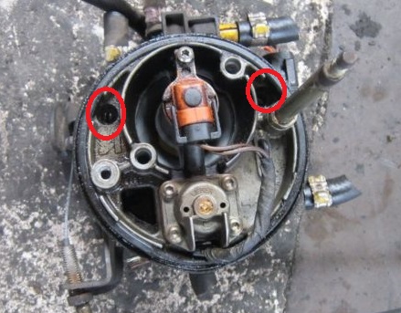

C chesh Established member Joined Dec 19, 2007 Messages 407 Points 206 May 25, 2013 #1 Where can I find them? one of them is broken and I don't want to buy a used throttle body. what could I use instead this plastic or can I find it somewhere? Attachments $(KGrHqZ,!rgFGNRSTG)dBRmhn3!oiQ~~60_58.JPG 67.1 KB · Views: 53
fingers99 Patron member Parked in the garage Written a guide Joined Mar 20, 2006 Messages 27,743 Points 4,560 Location Liverpool May 25, 2013 #2 I drove a Cinq for about 4,000 miles with both pins broken. AFAIK, they do nothing useful.
blu73 The Force is strong with this one. Staff member Written a guide Uploaded a resource/download Written a review Joined Nov 5, 2004 Messages 19,048 Points 3,433 Location Luke's Jedi Academy May 26, 2013 #3 :yeahthat: they only really help everything being in line when fitting the TB to the car, once on the car the bolts holding the TB on clamp it all together - pretty sure my car doesn't have either of them, they broke many moons ago.
