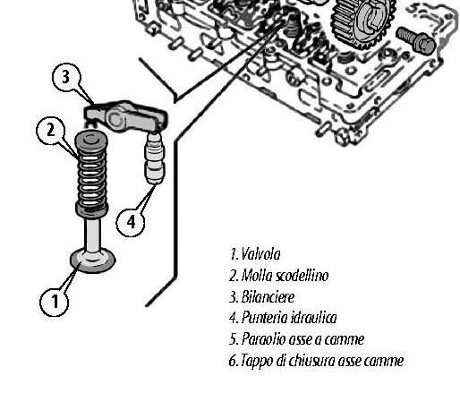

Here is a 16v hydraulic tappet:

I think C&B do them off the shelf. Arc, no real similarity tween the K series (which is more like the 8 valve) and the 1.4 16v Superfire (which is more like an ancient Lancia ;) ) which is where I got the notion of ye olde screw adjuster.
it was the T series i was on about BUT looking at them diagrams the T series ones are like the K series, i just took that as the norm on 16v engines of the 2 that i've pulled to bits (T series lump and cosworth lump). Why've fiat done this to us lol
looking at the pics from Kristian, and going off what i remember falling out of the 1242 16v.. they look like the other type, that first pic looks more like what i'd expect the 899cc's rocker gear to look like!
edit; after further reading on guy croft forum.. solid lifters, forget it!
If Kris's pic is right, it's relatively easy -- the shim under bucket style is exactly the way Alfa, Jaguar, et al did it in the good old days. Alfa were right, naturally. They are buggers to shim as you have to remove the cam and bucket every time to swap the shim out, but providing all the clearances are not out..............
