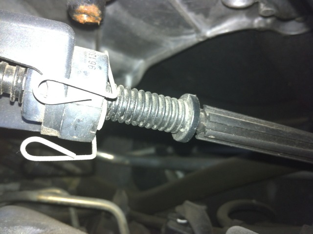

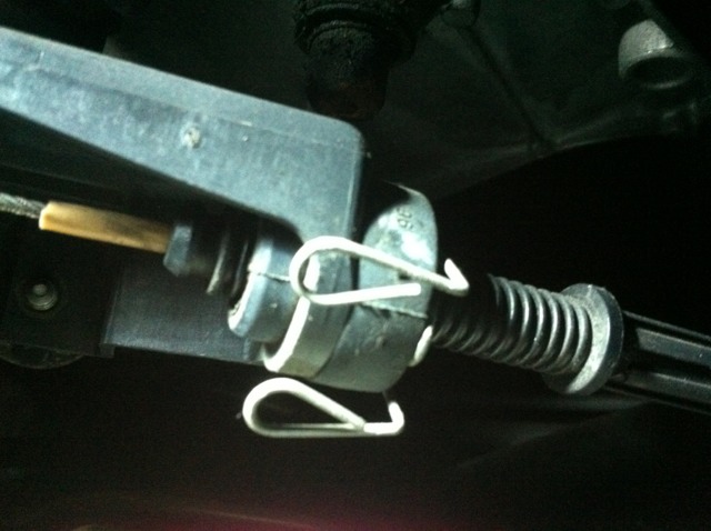

There is adjustment at the throttle sensor which is located just under the bulkhead (can be seen easily if you get a helper to operate pedal while you look under bulkhead).
You will notice that cable sits into a bracket behind sensor. You can pull the cable back towards cabin, pull off metal spring clip and reposition to tension cable.
This clip is sometimes missing due to an incompetent dropping into engine bay and not retrieving, so leaving cable slack. It can be purchased readily at most PSA dealerships but can also be made up from a piece of stiff wire.
If it is not missing and cable is adjusted to full and sensor is not opening fully the cable is obviously stretched and should be replaced as it could snap at any stage.
