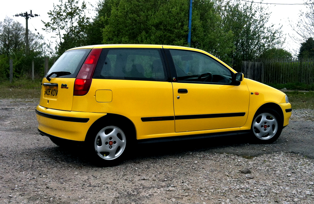

So do we get to see any pictures of this car then??
Found a handy guide by Dave which goes through the bleed proceedure. Pretty much as I thought really (y)
You have Alex's old GT don't you? Nearly bought it myself when he was trying to shift it!
Some pics here, just took them last night on the way back from collecting it.

Clear repeaters are on the list once I get this issue sorted.
But otherwise I'm just looking to keep it standard. It's totally stock at the moment and really tidy apart from a few bits here and there, such as the vinyl on the b pillars being a bit flakey. Just needs a bit of a tidy up here and there but is totally solid and the paint is in fantastic condition.
May look into dropping in the 1.4 16v lump in the future though. Makes more sence than tuning the 1.2.

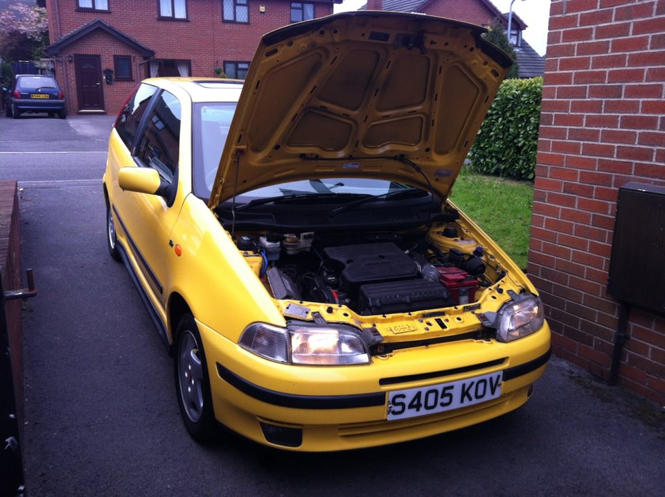

Just waiting for it to cool down now and I'll check if it needs topping up... Here's a pic...

Hmm.. Have you got the complete airbox spare? Could do with the hosing from the throttle body to the box thing that sits on the engine and then the bit that goes to the filter box at the front. Mines got duct tape around it at one point. Presume its split underneath. :rolleyes:
Oh also, noticed the Punto has aircon :slayer:... The whole system is there, just no button inside the car :bang:.. Presume the panel was replaced at some point for a non aircon one. Shame really. Guessing the aircon switch would just be a standard on/off switch though so if I can find the wiring, I may be able to hook up my own :)
